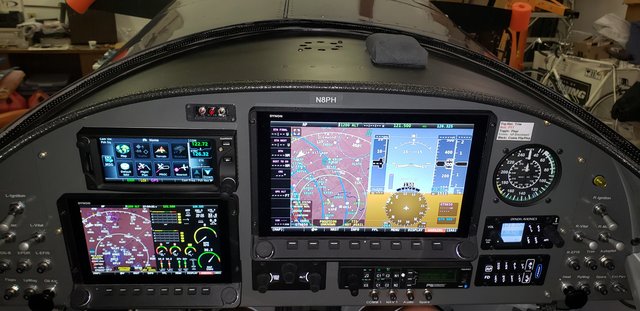

Your question implies a traditional radio stack, but assuming you’re planning to use one of the latest EFIS systems things are a bit different. With my Dynon Skyview system I can control the radio, transponder, autopilot and nav functions from the touchscreen in addition to using the moving map and charts. I laid out the panel so that the left side of the 10 inch Dynon, where I like the PFD, is roughly in the center right in front of me, which moved the Map, radio, transponder etc side to the right to a more natural position for me since I'm right handed.
With the main panel shifted to the right, there was no room to the right of it for the Avidyne IFD440 so I placed that on the left side where it's a little less convenient. I can reach it with either hand but its more cumbersome to use with my left hand. I can fly with my left hand or let the autopilot fly while using my right hand for the 440. I haven't tried it yet, but I can also use the Avidyne app on my iPad to control the 440. The iPad can be on my Kneeboard or on its mount on the right hand side above the lower switch panel, so I can control it with my right hand.
I also have a Skyview Radio panel and a Garmin Audio panel on the left side. Both can be worked with my right hand, but as mentioned above the Skyview radio can also be controlled from the main touchscreen and the audio panel isn't used often, mostly just an occasional button press to change radios or a knob turn to change volume. Both can easily be done with my left hand.
On the right side of the panel, I placed the two controls that I expect to use a lot, the Skyview knob panel (which changes the selected altitude, baro and heading) and the autopilot panel. When cruising along with the autopilot on I expect those to be my main interfaces with the system in addition to the main Skyview screen, and they've very convenient to my right hand.
My airplane has only been flying for a month so I don’t have much experience with the layout but so far it seems to work.
