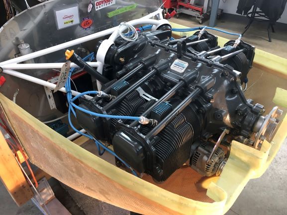

-And the exciting installation of the Poplar Grove assembled O-320. That really added some visual progress!
We accomplished this among other activities like flying our vintage 1946 Cessna 120, restoring a 1972 Triumph 500, Airventure Oshkosh, Motorcycle trips, and numerous other things in life. N951AC is coming along well. We're currently wiring firewall foreward, want to get that done of course before installing the forward skin. Then will get up on the mains, the next big visual progress item.

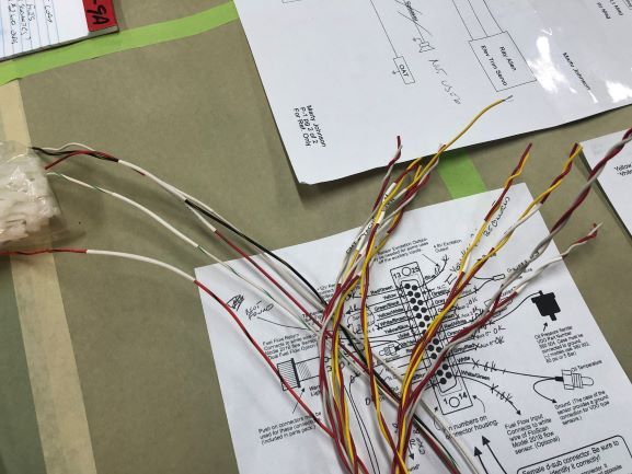

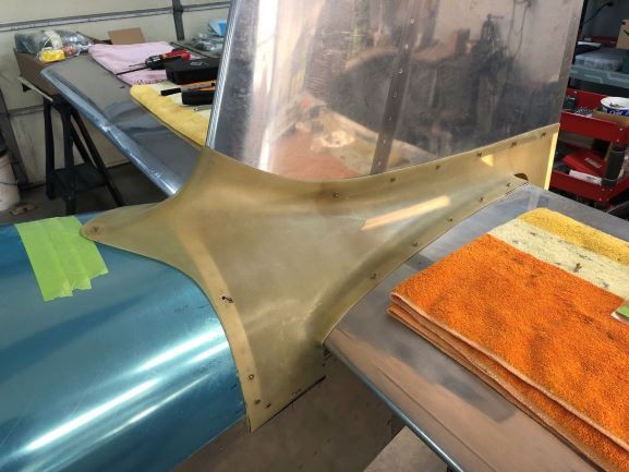

Work has continued on the 9A. We completed the fitment of the upper and lower rear fairings and removed the empennage until paintwork will start (we'll be painting the plane in my shop, but the tail, wings and fuse will have to be painted separately).

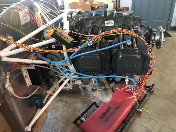

Then began the installation of some cables. Throttle, Mixture, Carb Heat, and Cabin Heat put into place initially. We've updated to the revised 9A nose gear and engine mount, no problems so far with routings etc, although if you were extra smart, you might do the firewall penetrations and some other things before mounting the engine. But it's not fatal. If you built these every day, you'd be a lot smarter. The second plane would be perfect.
Then on to wiring,,,, I don't hate wiring but I've found it to be the least documented aspect of the assembly, very slow progress, lots of head scratching.
We did at one point, fit the lower cowl to see what clearance we had for the EGT's. There looked to be good space for the orientations we had chosen.
But it's understandable due to the varied nature of each aircraft installation. I'm working from electrical schematics provided by Aerotronics with the panel that they built, and their support is amazing.

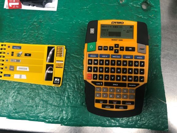

I did pick up a Dymo label maker ($60 off Amazon) and it prints on shrink sleeving. It works great.
I have found that it works best to tell yourself, "I'm going to focus on one thing today", as you do the wiring. Like, "Today I'll wire the EGT's". Small bites seem to work well, because if you try to contemplate the entire wiring job, your head will start smoking. And we know what happens when you let the smoke out!
