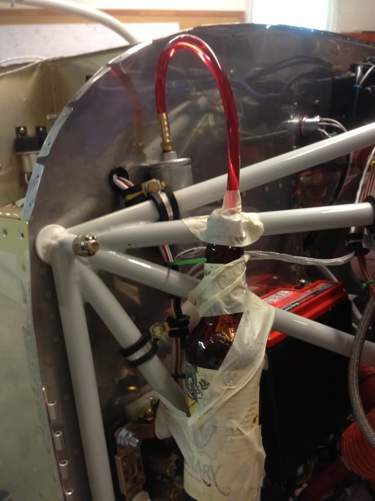

I bought a $12 garden sprayer and some various tubing to make a brake bleeder. The sprayer worked excellent I need to come up with a better sprayer hose to brake bleeder nipple connection and it would be mess free. I used a screw in connection to provide an overflow for the reservoir.

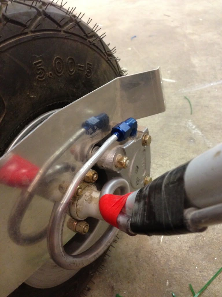

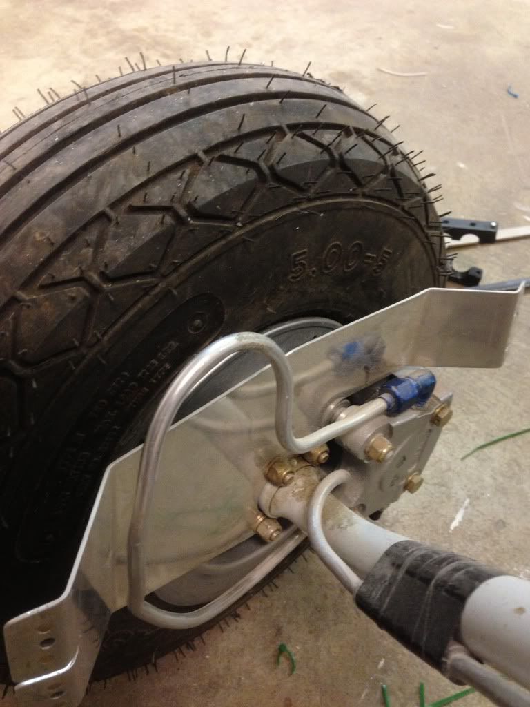

My tech counselor made fun of my cartoonishly large brake line loops so I shortened them up.
I like my new Rigid flaring tool,
1: crimp tubing in tool
2: cut tubing with hacksaw
3: file tubing flat with face of flaring tool
4: deburr tubing
5 : reset the tubing just shy of flush with the flaring tool and make the flare gently with some lube. 1 turn forward 1/2 turn back
My new smaller brake line service loop.

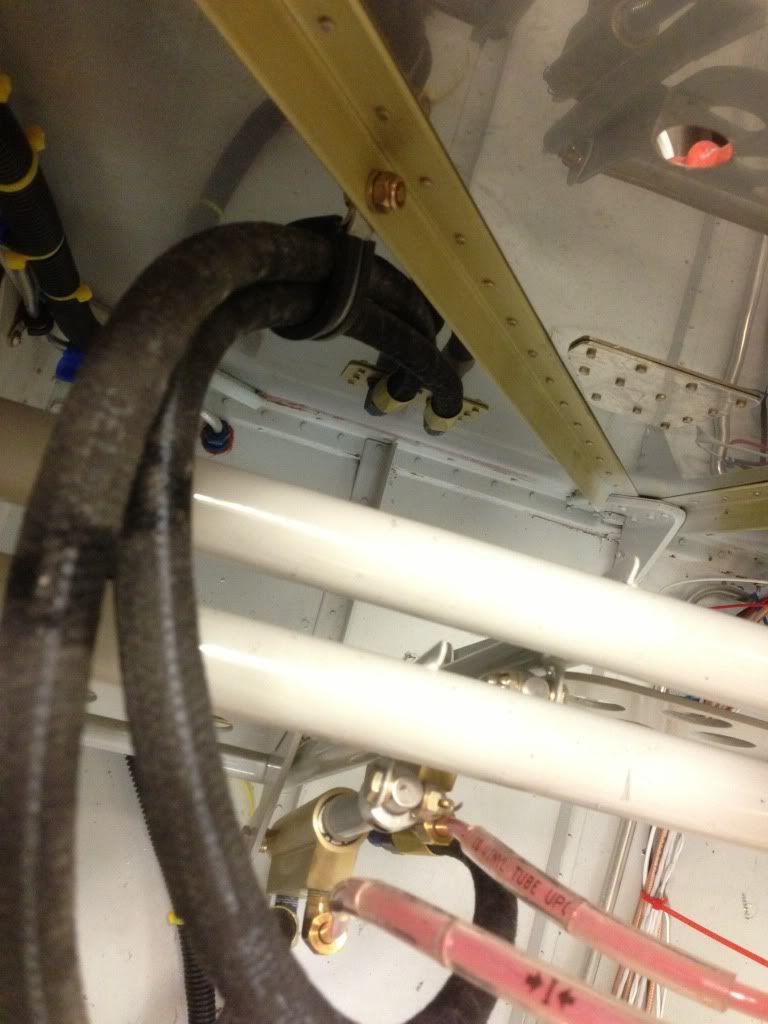

I added an adel clamp to the brake lines at the firewall.

Might want to check the flair angle , I do believe that's a plumbing / AC fairing tool , wrong flair angle for AN fittings .
Tom
Rv8
N 666 TA
First Flight 2-3-2015 🚀
  #140
Old 09-06-2013, 08:23 AM
crabandy crabandy is offline
Location: Ottawa, Ks
Posts: 2,411
Tom, it's the Rigid RFT 37* from Genuine Aircraft Hardware. Thanks for keeping an eye on me though!
