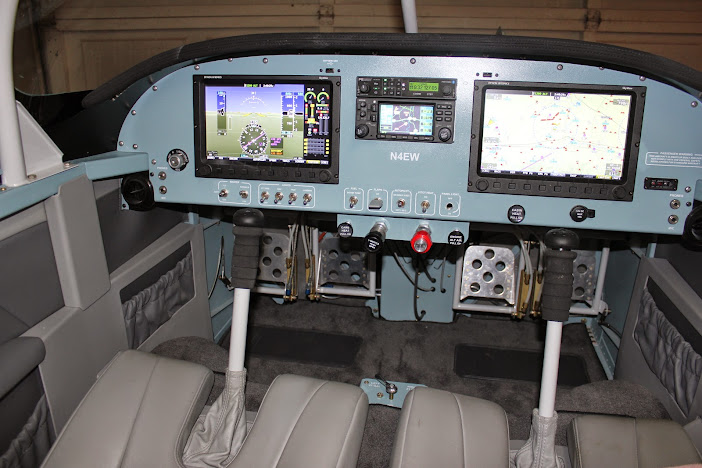

Finally done. Pardon the empty hole, I had to send the Trio Pro-pilot back for repair. I'm really happy with the layout of the equipment and switches so far.
GRT HXr, 430W, A210, GTX-327, Trio Propilot, GRT Mini-B, PSE 5000EX, 2 fuse boxes (Master buss and E-Buss), backup (alarm) battery wired to the E-buss for avionics brownout protection during startup and emergencies, dual alternators (N-D (Honda) and an SD-8) and an emergency feed from the Oddysey battery to the E-buss, for when it all goes REALLY wrong.

Very nice, is that the 12.1 HXR?

Great layout. You'll probably see a few more copies of this down the road. For some of us, we could probably use an annunciator light next to the lower placard.
Thanks! Negative, it's the 10.4, but it's stuffed into a standard height panel, because I didn't want to sacrifice any maneuvering room.
Terry, CFI
RV9A N323TP
Thanks. Maybe I should print another one in yellow or red and put it above the HXr...

I just have to ask... Is that cabin heat cable from a vintage Ford?
I think it's from a cherokee 180. I didn't build the plane, but that's what the engine was on, I got rid of all the old cherokee switches and breakers when I did the panel, but figured I'd leave the cabin heat knob for posterity.
