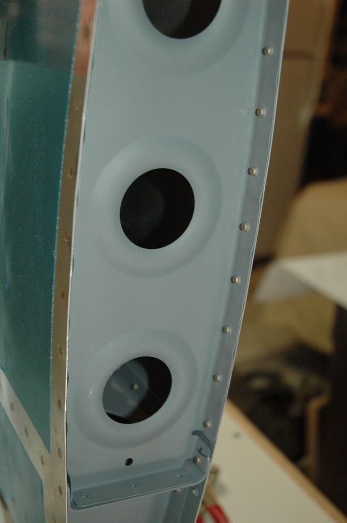

Mohammed,
Fluting is only necessary if the part is not flat. You may find that some parts need very little or no fluting as they come from Vans. Look at the pic below and you'll see how subtle the fluting is on this HS rib.
