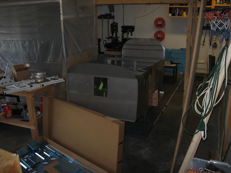

The wings are sitting in the cradle without the bottom skin rivets done and the wing tips and plumbing to go. I decided to go with a quick build fuselage which Vans had in stock. I had it shipped to arrive just as my flaps were completed. The fuselage looks good. I've notice a couple odd things so far, but not concerning. The firewall was already dimpled, yet I was still needing to match drill the recess. Second item is the seat ribs where the stick control columns attach were not complete. The inner most ribs had the access opening with nut plates but the next ribs over did NOT have the 1.5 inch hole cut with trimming to allow the control stick mount (WD610 I think) to fit. It looks like there should be clearance to get in there and drill it out.
The flap trailing edges in this picture were not done yet. They are sitting on the table letting the pro seal set up.
Picking up quick build at ABF freight
It took about 6 hours from arrival at ABF freight until it was unpacked and all items inventoried.
