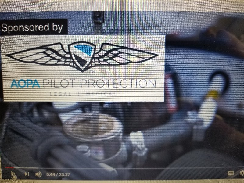

I was watching a youtube flying video and someone commented that this sludge buildup on the oil filler neck was definitely not right. Is this what happens with the condensation inside the engine? I'm new to aircraft engines and trying to learn what to look for. This was on a Beech 6 cyl by the way. Sorry for the crappy pic.

Originally Posted by Yen View Post
I would think you are having some serious moisture problem if the oil is white and foaming. I have never seen that in a normally operated engine, but I do live in a fairly dry climate.
Sorry, but a dry climate has nothing to do with it. The engine combustion produced a high water content. And combined with sulfur in the fuel condenses through out the engine crankcase.
I am now working on a purge phase using a mattress inflator. Calculations confirmed with data indicate 3 min will yield ambient moisture content in the crankcase. A 3-5 liter/min flow through a desiccant will replace the ambient moisture with very dry air in 30 min, but for safety 60 min is recommended. Doing this does not require recirculation. A quart of desiccant should not need regeneration for months, and is not contaminated by oil.
To the OP - yes that helps and should be done, but a purge with mattress inflator, or vacuum cleaner for 3 min will complete the process.
It depends on the oil you use. The white sludge you see in your photo is what I use to see when I ran Exxon Elite. I would find some on the dip-stick and sum under the valve covers. That oil was formulated to do this in the presence of moisture.
