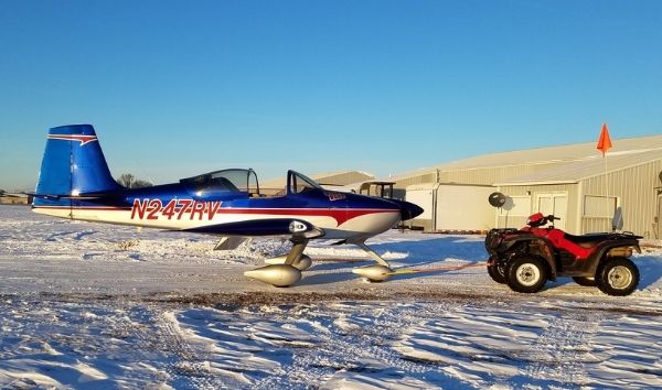

We have my old lawn tractor (not quite as cleaned up) in our group hangar with a simple hook on the front bumper for backing up to pull aircraft over the hangar door tracks when needed (no second hands nearby or a little ice outside the door sometimes). But its a weak steering arrangement for the nose gear aircraft. Do you have more pictures of the linkage/attachment you use?
(I want to design a simple nose gear lifting arrangement like the bigger commercial tugs have. Something that RVers could build. But other jobs keep that project on the back burner.)

My hangar-mate has an RV8A and has fabricated a custom towbar to use in conjunction with a lawn tractor to push the airplane back into the hangar. Much as I hate to admit it, this solution doesn't work worth a hoot. The steering traction of the tractor is far less than the sideways force applied by the airplane when a main wheel hits something other than perfectly smooth ground. It kinda looks like the tail wagging the dog. Hit something with a main wheel and it caused the aircraft to pivot, pulling the tug sideways.
As a result of our negative experience with the lawn tractor I've obtained a compact tractor for which I will fabricate a nosewheel lifting device attached directly to the tractor frame. With the nosewheel completely off the ground the airplane will be fully under the control of the tractor's steering. I think this should be the ultimate solution, particularly on ice and snow-covered ramps where the 4wd and hydrostatic transmission will move airplanes with precision and authority.

Pushing a nose-dragger would be more involved than pulling a tail-dragger. I suspect you would have better results with backing the tug verses having it nose-to-nose with the aircraft. This would put more weight on the end of the tug where the tow-bar is attached.
Even when backing up the tug while pulling a tail-dragger some technique has to be learned (I'm still in the learning curve). Turn the steering wheel left and the tail of the plane initially moves right. It is a matter of anticipating the maneuvering required.
I use the same Cessna-type tow-bar that I have used for the soft-tissue tug for 18 years. There is a carabiner on the handle that clips onto an eyebolt on the tug drawbar.

Been using this for three years with good success. Only problem is that when your wife sees how well it works, she is gonna need one, too.
