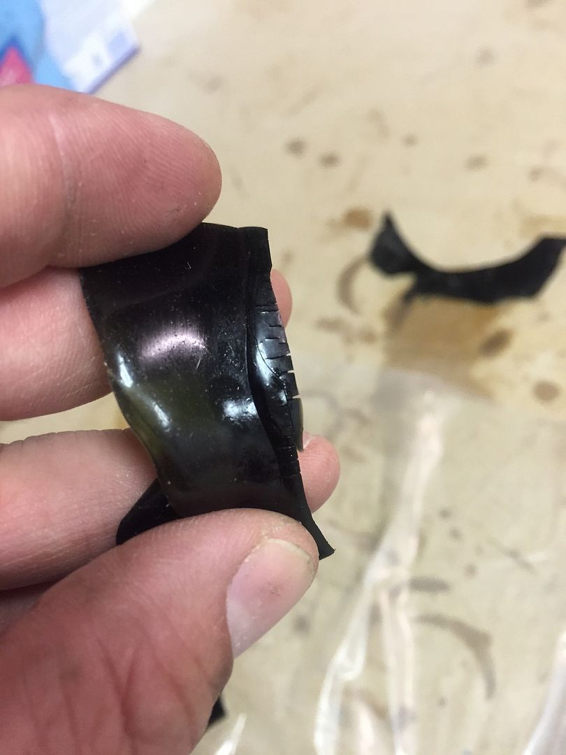

I soaked some room temp cured samples of the PMC780 dry in water, oil (chainsaw bar is oil) and 2 stroke mixed gas for the last several days. I visually compared and stretched/twisted etc the samples reference a piece of un-soaked urethane rubber. I couldn't detect any difference between the samples soaked in water or oil versus the un-soaked piece.
The piece that was soaked in 2 stroke mixed gas looked and felt normal at first, the bending and twisting seemed to start small cracks on the edge much like an old alternator belt or radiator hose.

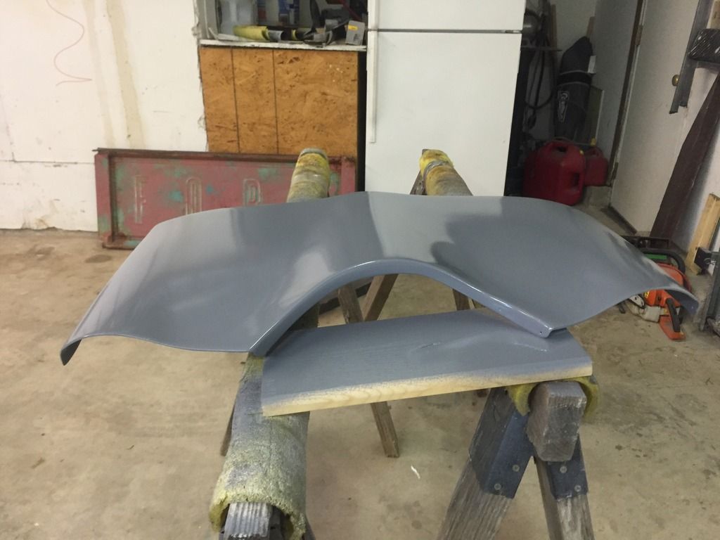

I primed my glass with a DPLF epoxy primer followed by a high buildprimer, of course a few pinholes showed up where I got over zealous sanding the epoxy skim coat. Next time I'm going to shoot the epoxy primer only, fill remaining pinholes with epoxy/micro sand then shoot the high build primer.
I wet block sanded the plenum, I really like the contrasting colors of the high build versus epoxy primer. I'm getting closer.

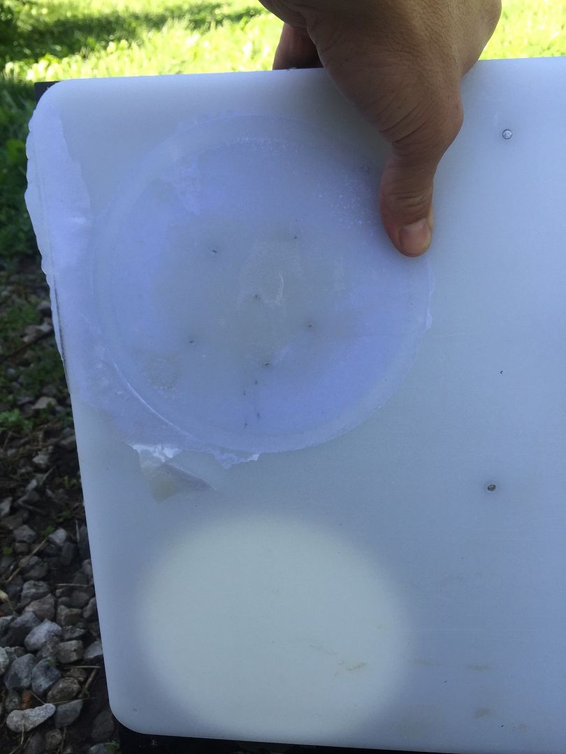

I'm thinking my way through the front of the intake boot, I routed a 1 inch wide by 1/2 inch thick circle in some plastic to act as a mold for the front rubber lip.
I also routed a 3/8 inch wide by 1/4 inch thick ring to act as a mold for an epoxy/flox reinforcement ring. This reinforcement ring will sit in the intake boot front lip and be covered with rubber......in theory anyhow. The reinforcement ring is still curing, I ran out of fast hardener and had to use slow. I clamped a flat piece of plastic over the mold to flatten the back side.
