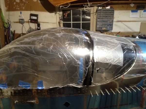

Finally had some time after the Holidays to Sikaflex in the aft window on my tip-up canopy. Lots of clamps, but the mess was manageable.
I couldn't help pulling back the protective plastic to see how it looked. I had beveled the aluminum skin which gives a nice finished look and also provided the necessary space between the window and the skin for the Sikaflex.
I was pleased with how the two sections matched-up. I'm thinking I'll add a fiberglass targa strip to help with noise and to keep rain out.

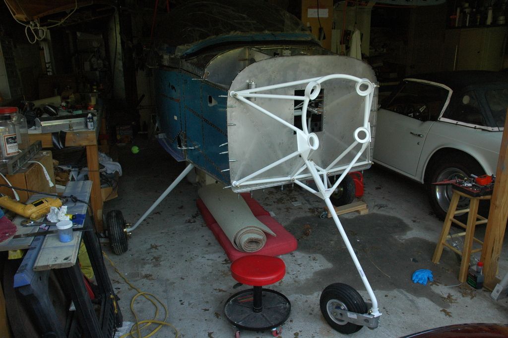

She's got legs....
Got her up on her wheels the other day. Thanks to Tim Emig for his help drilling the fire wall and attaching the engine mount.

Getting the gear on is a big step! Now it looks like a real plane, and neighbors don't think you're building a canoe anymore.
The only downside is it's harder to climb inside...easily remedied when you put the wings on.

An RV-9A and a TR-6... am I right? Nice pair.

VERY good - you know your classic roadsters.
1973 TR-6 all original. Probably the only TR-6 in existence with no rust...
