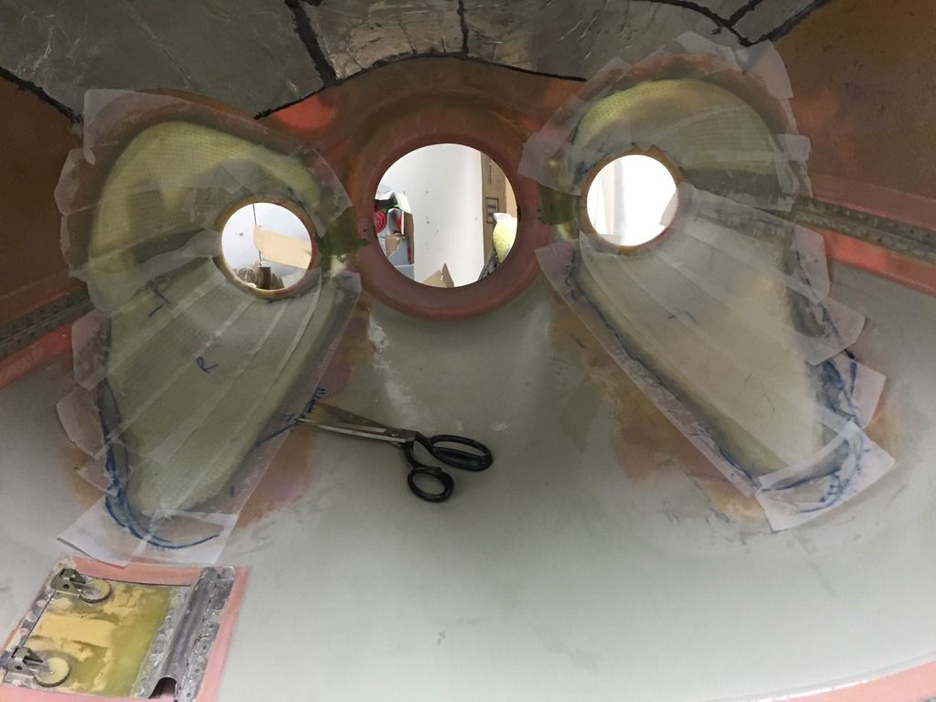

My first full half day I've had to work on the airplane in over 3 months summed up in 1 photo. The existing cowl/honeycomb was cut/sanded at an angle, a fiberglass soric sandwich was placed in the newly shaped areas with an epoxy/flox butter evening out the seams and an extra layer of glass over the seams topped with peel ply.

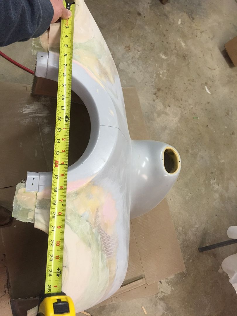

The ol' yard stick straight line sawing jig and flush trim saw did another decent job making the split.
The top of the lip seems to be fine, fat enough and blends in with the rest of the cowl.
The outboard side of he cowling on the other hand has the fat lip than quick transition to a "pitot" tube.
I think inlet is placed fine vertically but needs to be moved inboard 3/8-1/2 inch, moving the inlet inboard would give me the geometry to work more curve on the outboard side like this:
As it sits now I think it's too flat to easily insert the horizontal hinge pin holding the cowling halts together. It's also a little heavier due to some extra glass and filler. I'm going to sit on it and ponder.
BillL or DanH do you happen to have a dimension between the center of your round inlets?
RV 7 590 hours and counting
21 donation done
  #398
Old 03-04-2016, 09:43 AM
BillL BillL is offline
Join Date: Sep 2007
Location: Central IL
Posts: 6,322
SJ long cowl, RV7, 23 15/16" or 1/32" less center to center distance for inlets. The design dimension could have been a 24.000, but my glassing of the inlet rings is off that much.
Bill
RV-7
  #399
Old 03-04-2016, 02:07 PM
crabandy crabandy is offline
Location: Ottawa, Ks
Posts: 2,317
Thanks Bill, mine are pretty close at 23 5/8. Hmmmm, more coffee sipping staring and thinking.

If I had it to do over again I probably would move each inlet about 3/8" inch inboard for more outside curve, but I'm moving on with the existing inlets. I carved out a spot to nestle in the forward section of the new hinge, it helped with the angle for inserting the hinge from the front. I followed the Van's instructions on drilling extra holes and aggressively sanding the hinge flange and epoxying it to the cowl, the old hinges were not letting go virtually welded to the cowl. I used the hinge pin and an extra piece of hinge to position the new hinge with the existing hinge. After the epoxy dried I riveted the new sections.
I really should've waited to make my plenum until after re-shaping the cowl, oh well it's just fiberglass. The new cowling shape allowed for a slightly larger rounded opening up front, I thought about laying up a new plenum in the cowl but would be left with the flanges fitting the baffling problem again. I decided to shape some pour foam on the top to sand to shape. I laid the existing plenum in the cowl and measured a rough arc prior to pouring the foam.
Sanded to shape laying in the top cowling, about 1/8 shy for extra wiggle room.
I laid 2 plys of glass over the newly shaped foam. I poured more foam over the top of the plenum as reinforcement to hold the shape as I cut out the old fiberglass and foam.
Inside of the plenum sanded and ready for more glass, I cut the soric and glass but I'm waiting on more epoxy to finish it.
I also spent some more time sanding things to shape on the outside of the cowling at the juncture of old vs new cowling, a little more filler here and sand more off there....I think my main problem was trying to shape the curve with my larger 12" sanding block, it was sanding all of the curve out and I needed a smaller 4-6" block to shape the curve.
