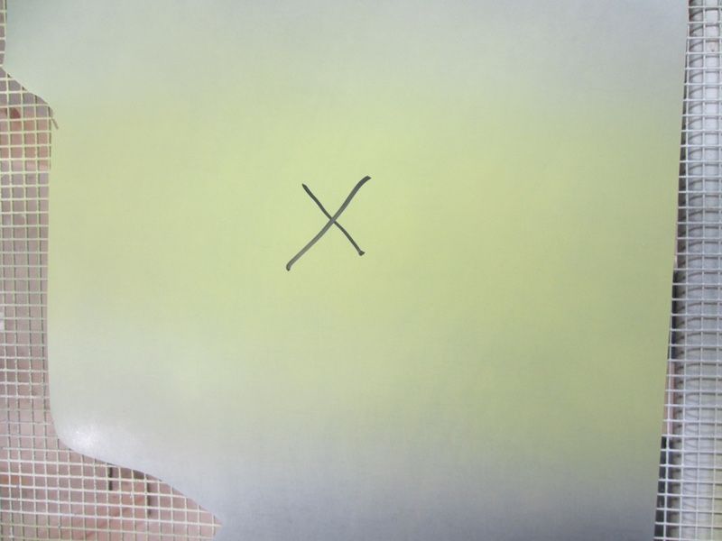

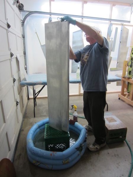

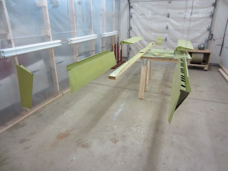

Finally started exterior paint. Process has been to scotchbrite, solvent wipe, acid etch, rinse, alodine, rinse, prime with AkzoNobel. First time using an HVLP gun. Still need to tune this a bit.
Alodining - new use for grandkids pool. To cold to do this outside.

First Batch Primed
[IMG][/IMG]
Sharpie mark under prime on test panel. Hope this isn't to thick.
