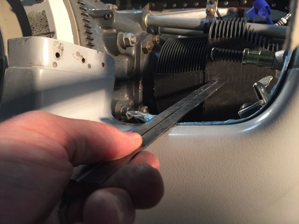

Pic of my left inlet ramp, I glasses in the inboard portion to give the baffle material something to push against. The left hand forward baffling is removed in this pic, lots of room between the top of the cylinder and the curved top of the cowl.
Right side has the top of the cylinder squeezing together with the bottom of the top ramp, I should have cut some material off the top ramp and moved the curve forward.
I'm planning on cutting both ramps out and using a diffuser boot instead.

I'm not sure of the angle I should make with the bottom of the inlet. The existing inlet points downward, the metal baffling points back to the middle of the cylinder. Should I leave the downward angle initially then angle towards the middle of the cylinder as the top of the new diffuser boot can expand on the top side?

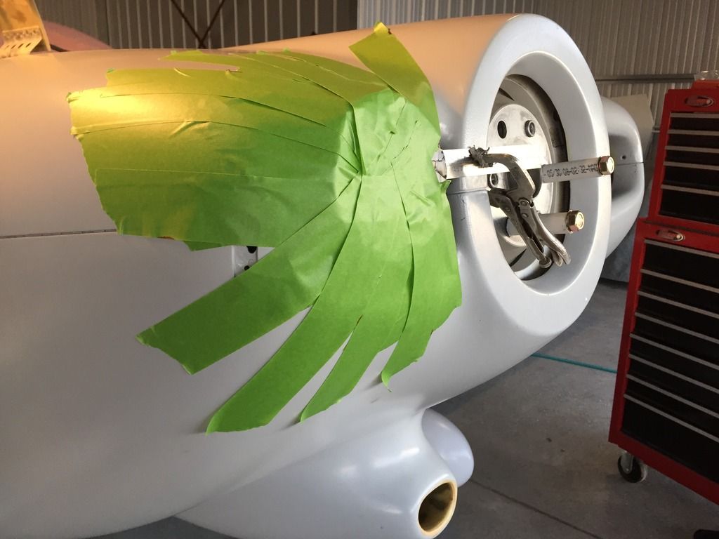

I roughly measured my right inlet with the more restrictive upper cowling ramp in 3 different places, front-middle-aft end of inlet. Due to the shape and access, the cross sections are basically square and I used pieces of paper to gauge the size and measured the papers. Almost the same vertical dimensions with expansion sideways. The top page is the side view and measurement of the inlet in inches. The bottom page shows the inlet from the front-black, middle-red, and rear-purple with rough total areas denoted in their color square.
I've made no progress in trying to pick an inlet, I'm trying to decide between making a smoother larger diffuser shape behind the Van's inlet or make a new round inlet and diffuser. The Van's inlet is harder to seal and make a diffuser for, the round inlet involves reshaping the front of the cowl.
Here's a 5 inch circle mounted in the center of the Van's inlet, I think for asthetics and diffuser shape it should be moved above the cowling split line and outboard toward the outside of the cowling.

Good start...measuring, playing with shapes and locations, and thinking.
As velocity ratio (velocity through the inlet divided by freestream velocity, Vi/Vo) goes down, duct shape inside the inlet becomes less critical. As velocity ratio becomes higher, internal diffuser shape becomes more critical.
You've measured the stock inlet and find it to be 21.29 sq in. A 5" diameter round inlet would be 19.625", only slightly smaller. Assuming no other changes (notably exit area) there would be no appreciable difference in Vi/Vo. Any gain in conversion of dynamic pressure to static pressure would have to come from an improvement of the internal shape.
Bill Lane obtained a good text when we were talking about ducts earlier this year. Here's a snip, the first paragraph of the chapter on diffusers, credit Applied Fluid Dynamics Handbook, Robert D. Blevins:
Note the part about boundary layer. Any large, stable separation results in less static pressure, as does a shape or separation that results in jet flow. Again, from Blevins; you want #1 or #2, the latter resulting in the highest Cp. #3 works OK. #4 and #5 are bad news:
So how to apply this very basic knowledge to your application? First realize the stock Van's inlet is sized for moderate Vi/Vo, as would your new round inlet. A lot of the diffusion (conversion of dynamic to static) is happening out in front of the inlet, and actual velocity through the inlet is significantly lower than aircraft velocity. That's why we can get away with the crappy duct shapes...the sharp angles, edges, and steps that would trip a faster flow. I would expect only moderate improvement in pressure recovery with improved duct shape alone.
Still, we'll take all the pressure we can get. Once you settle on which Vi/Vo scheme you wish to pursue (the size question), the inlet shape and location largely depends on what is best for duct shape and sealing. Do all you can with shape, but since here the low velocity ratio makes shape less critical, sealing is where you can probably make a significant improvement. Let's face it, the typical flap sealing around a GA inlet is truly awful.
Bottom line? At this inlet size, simply avoid big pro-separation duct errors, and let seal design be the primary driver of the inlet shape and position.
