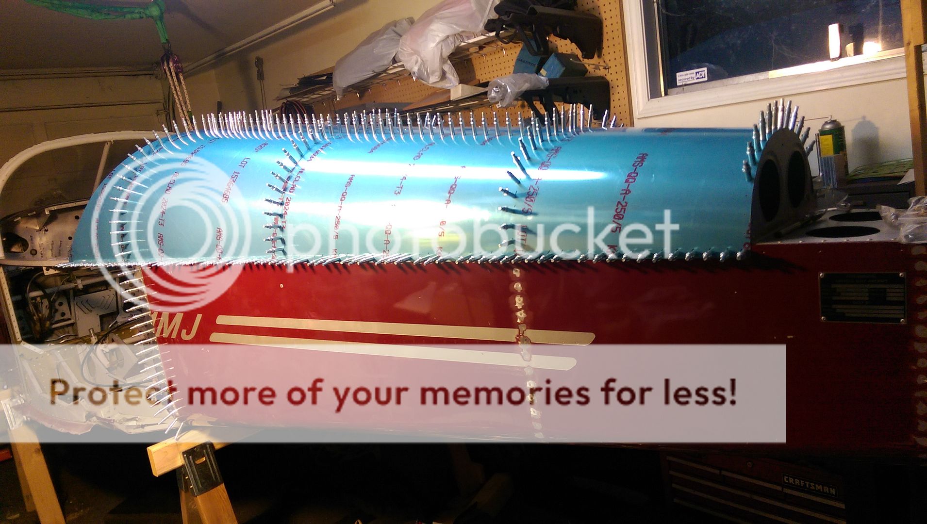

kentlik 03-10-2016 11:00 AM
RV-7A rebirthing

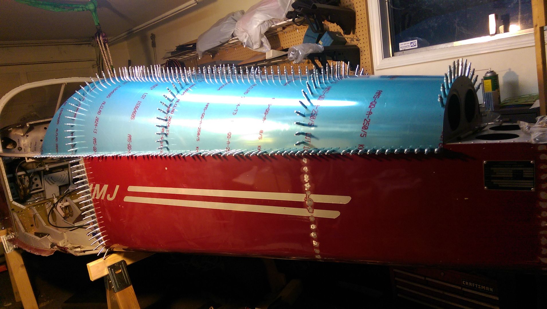

So I started the long process of unbending my -7A...
Going to be a long road, but worth the effort.
She went down in Nevada, moved to CA, now based in Portland OR.
Not much straight on her but she is resting comfortably...
Started the removal process and it is not bad, at least the easy to reach rivets aren't.
Will keep you posted on what I uncover deeper into her innards
Kentlik

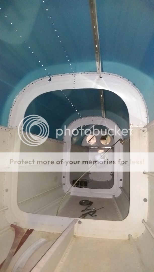

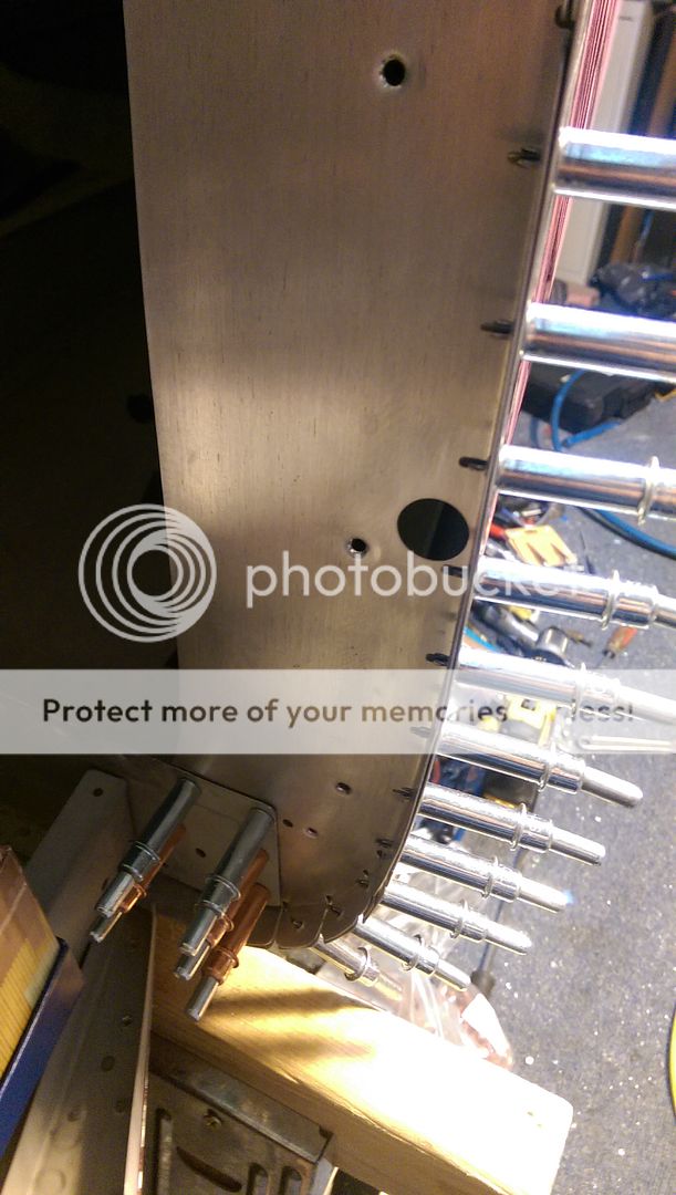

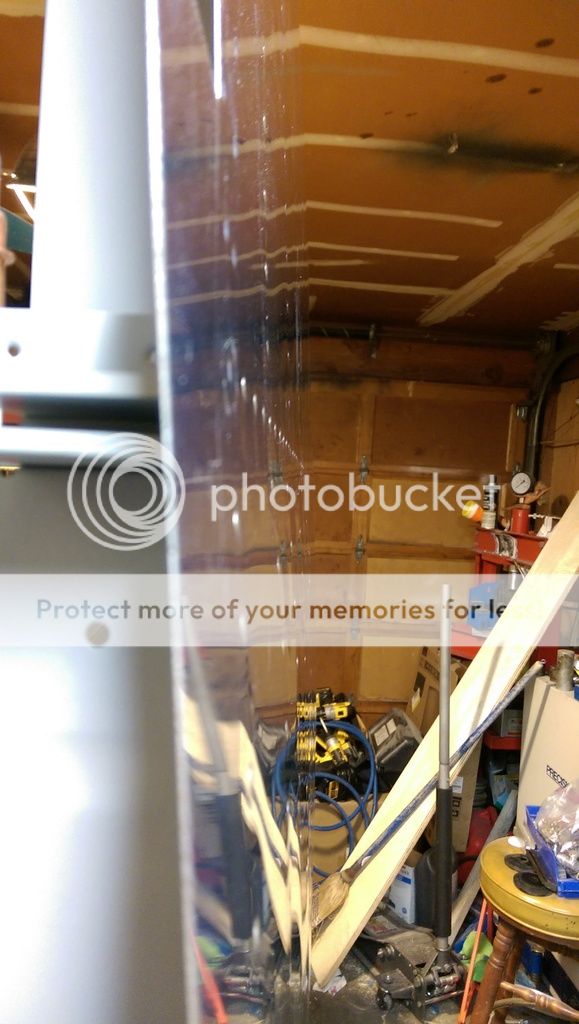

kentlik 06-28-2016 02:25 PM

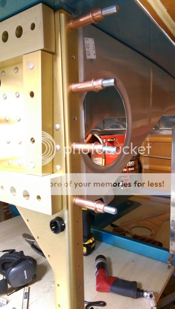

bucking rivets
Moving forward...thanks for the help Darrell of Aurora/Hubbard, OR.

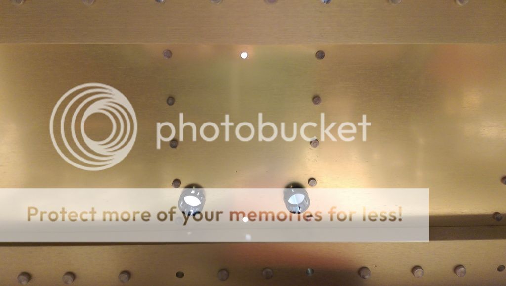

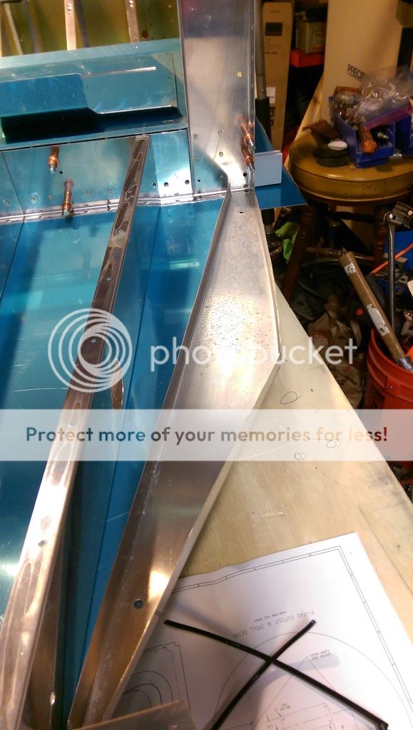

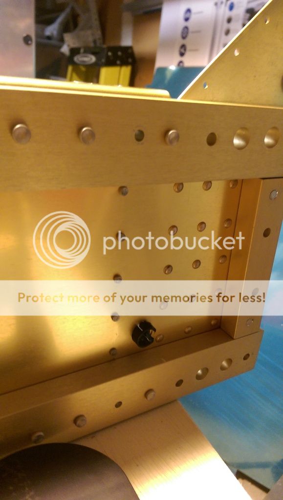

kentlik 07-18-2016 10:15 AM
Bulkheads

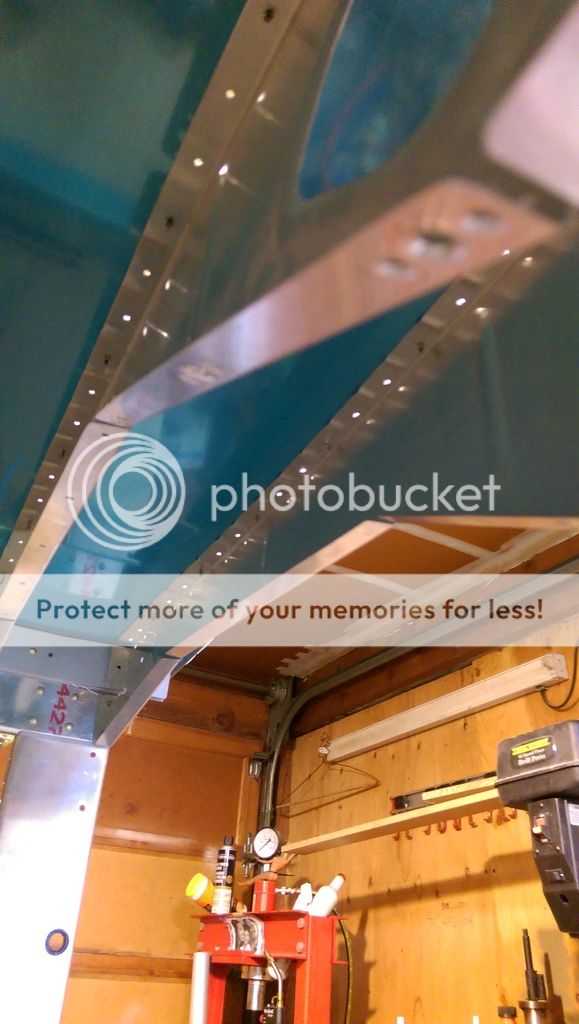

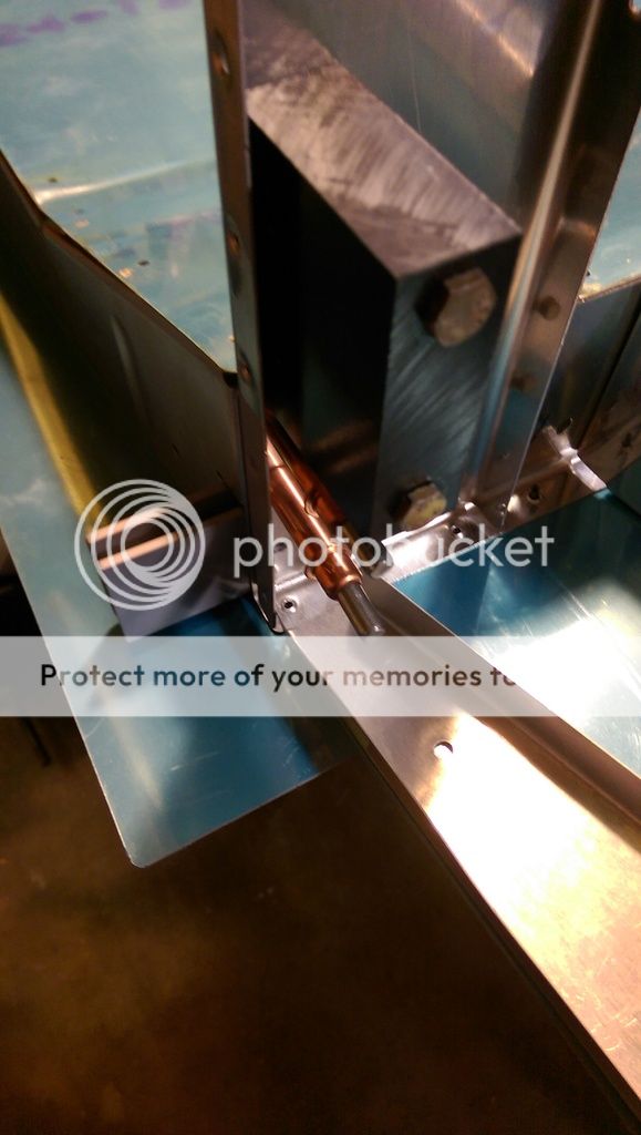

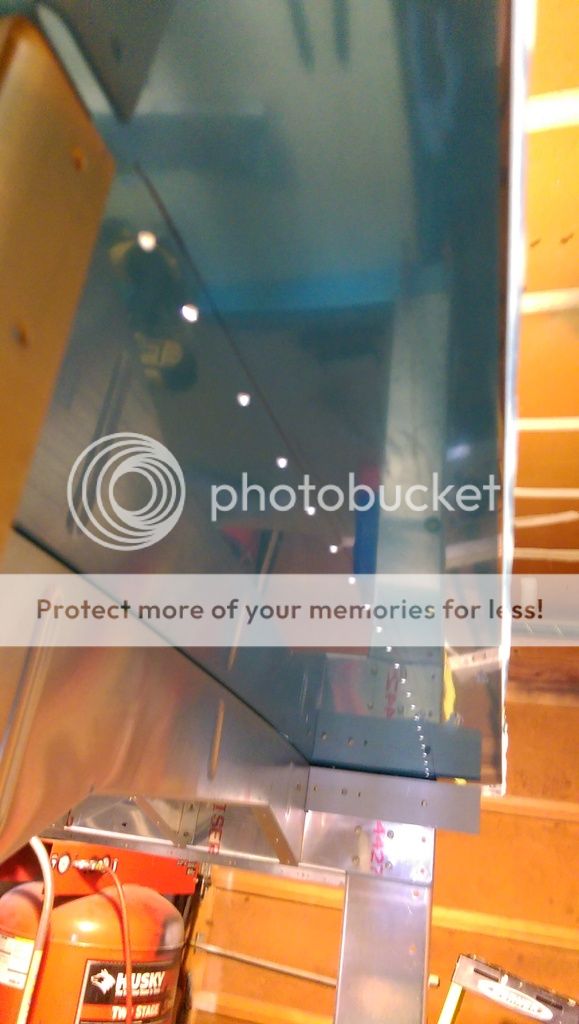

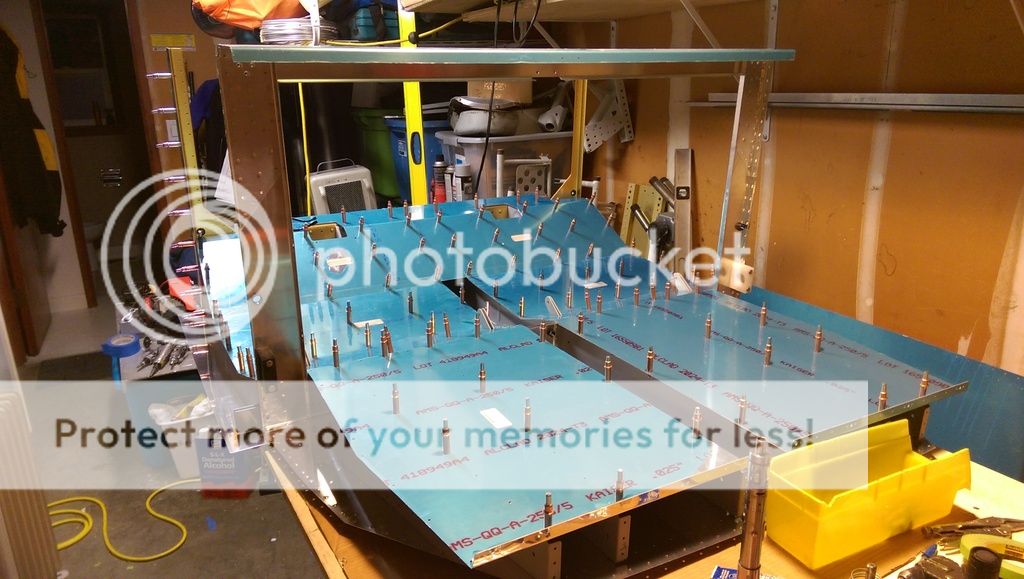

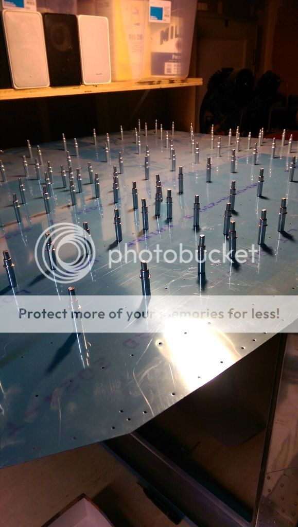

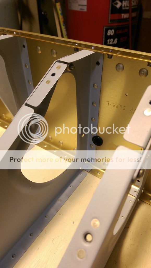

kentlik 08-10-2016 09:34 AM
Drilling rivets to remove center section

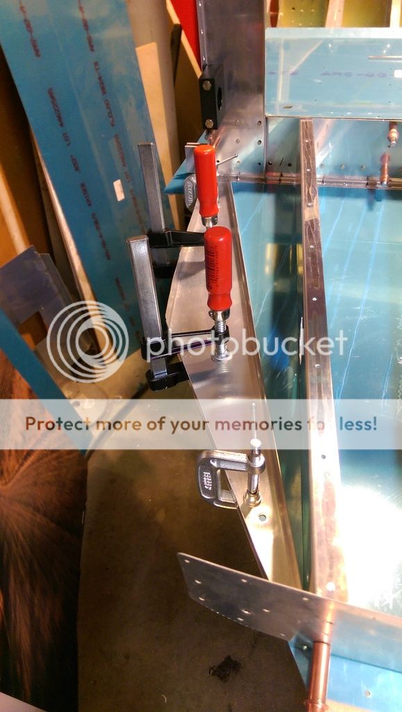

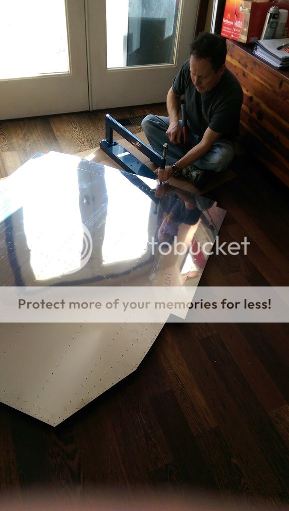

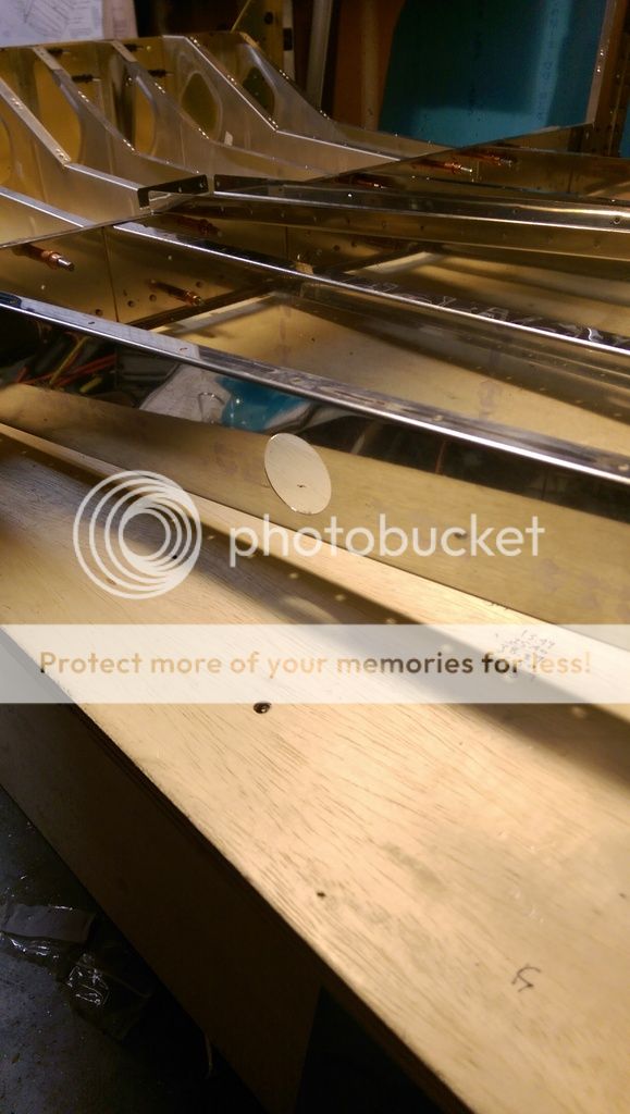

kentlik 08-15-2016 05:31 PM

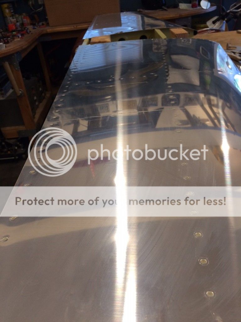

Some bent stuff being repaired and some straight stuff
Made some good headway last couple days. Slow but this is going to be rewarding as it is difficult.

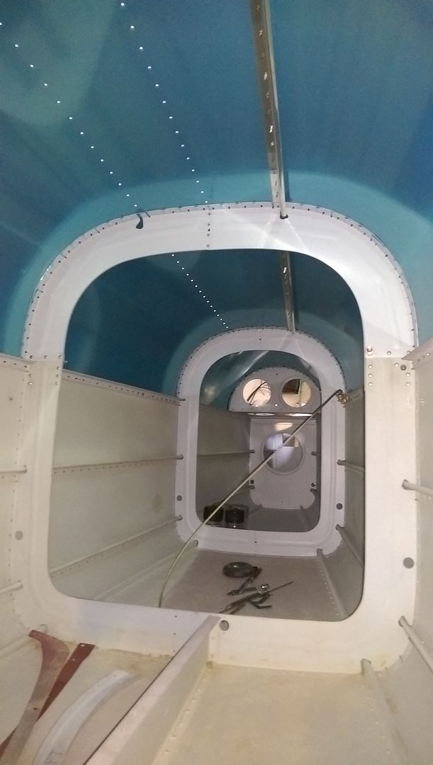

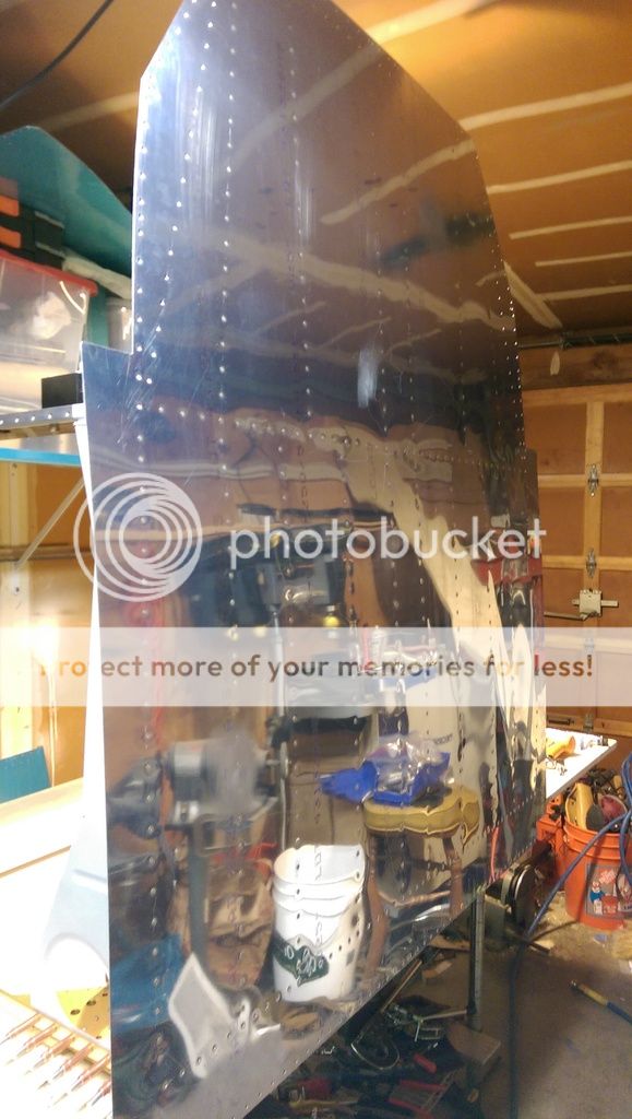

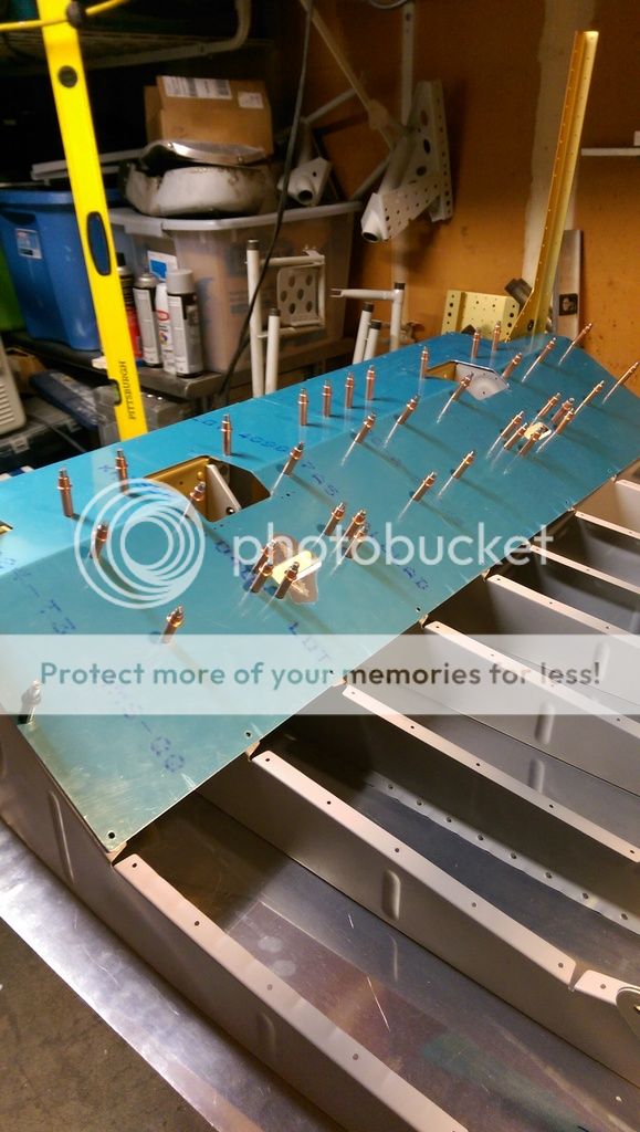

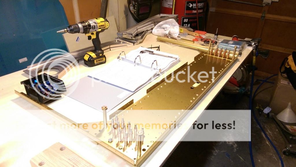

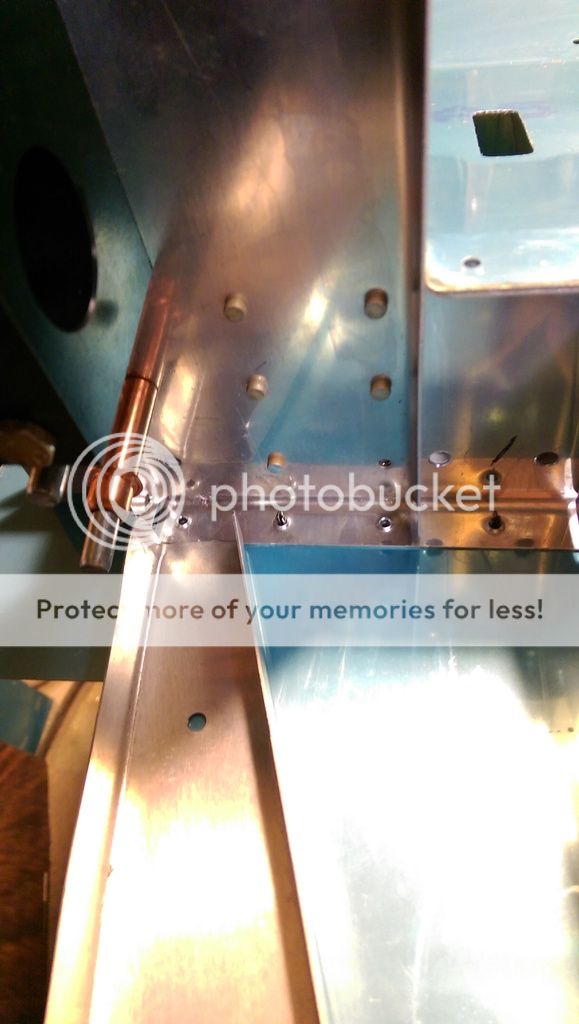

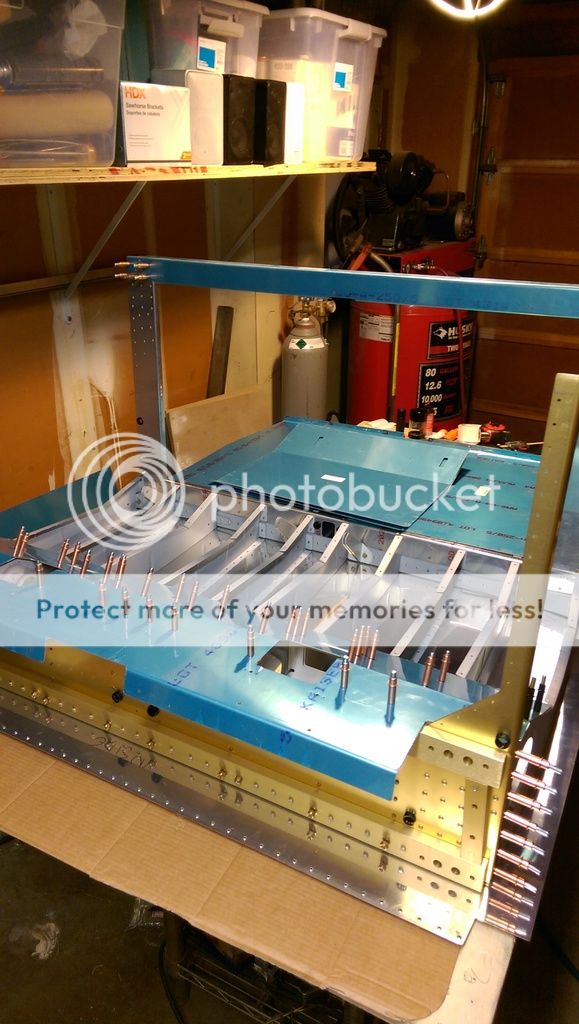

kentlik 09-05-2016 09:39 PM
Getting the aft skins sorted out. Bulkhead replaced

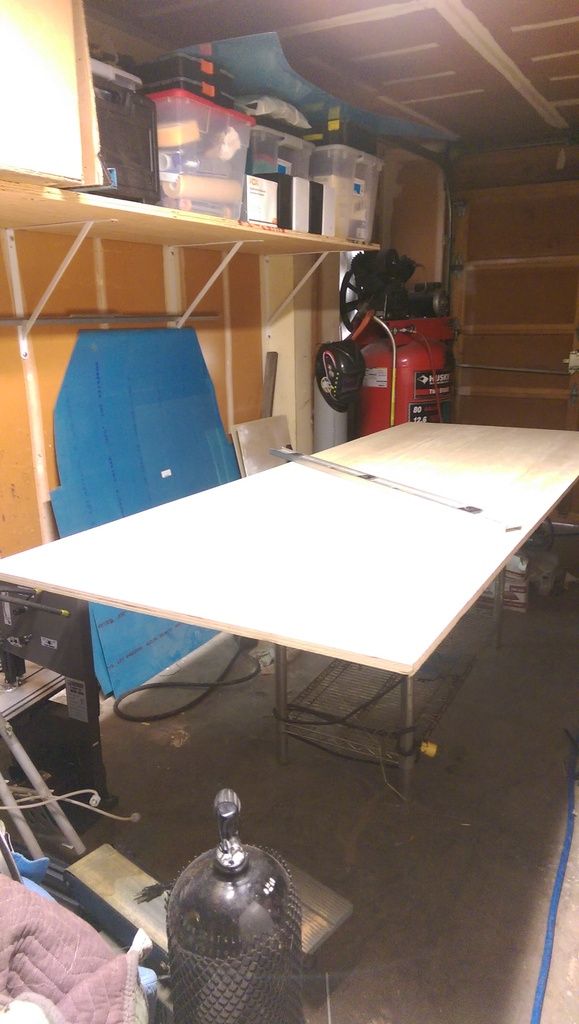

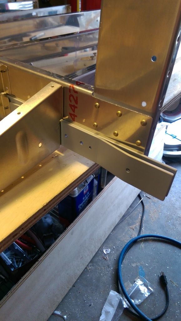

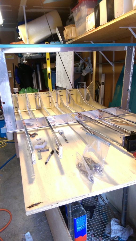

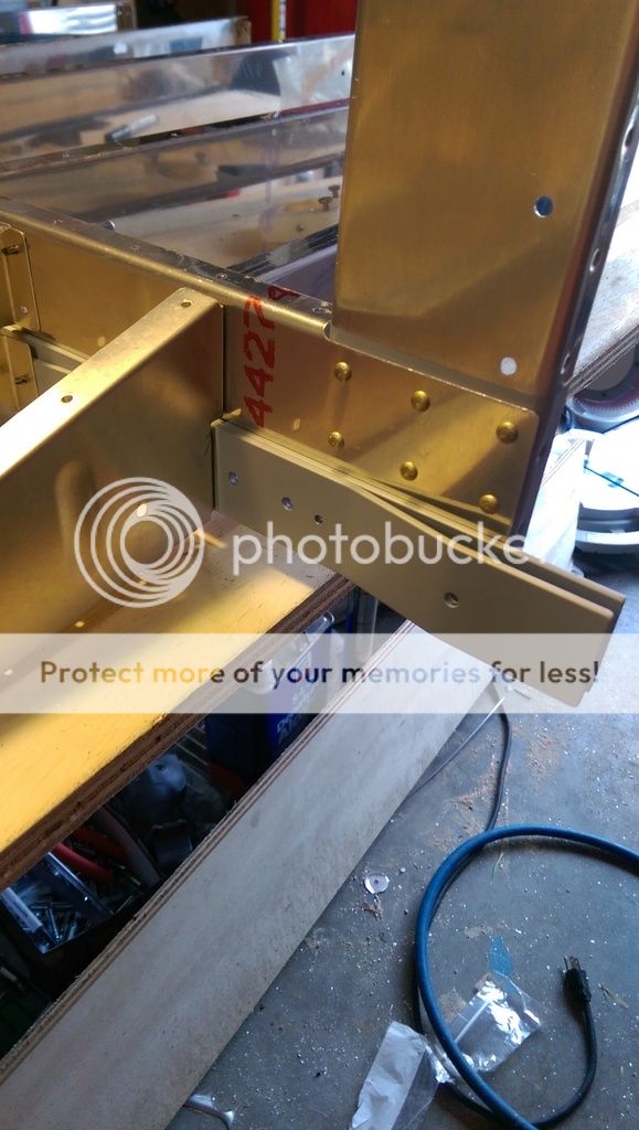

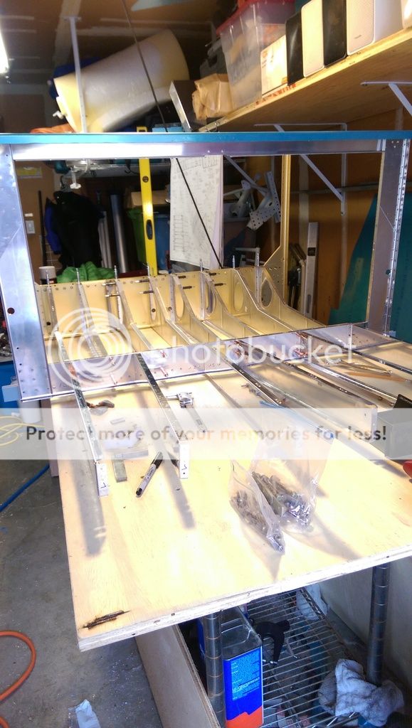

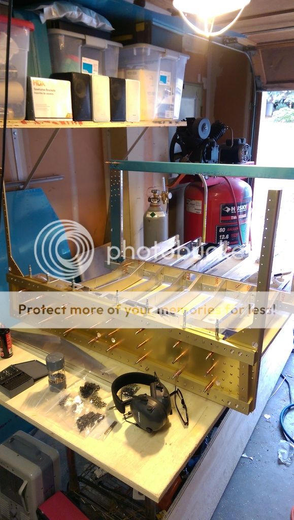

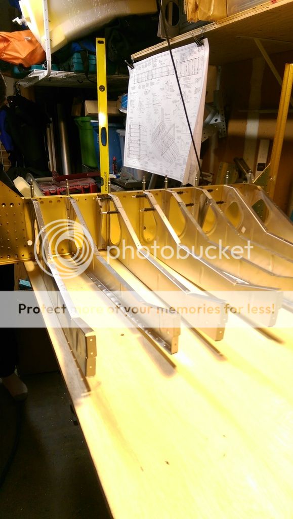

kentlik 02-02-2017 03:30 PM

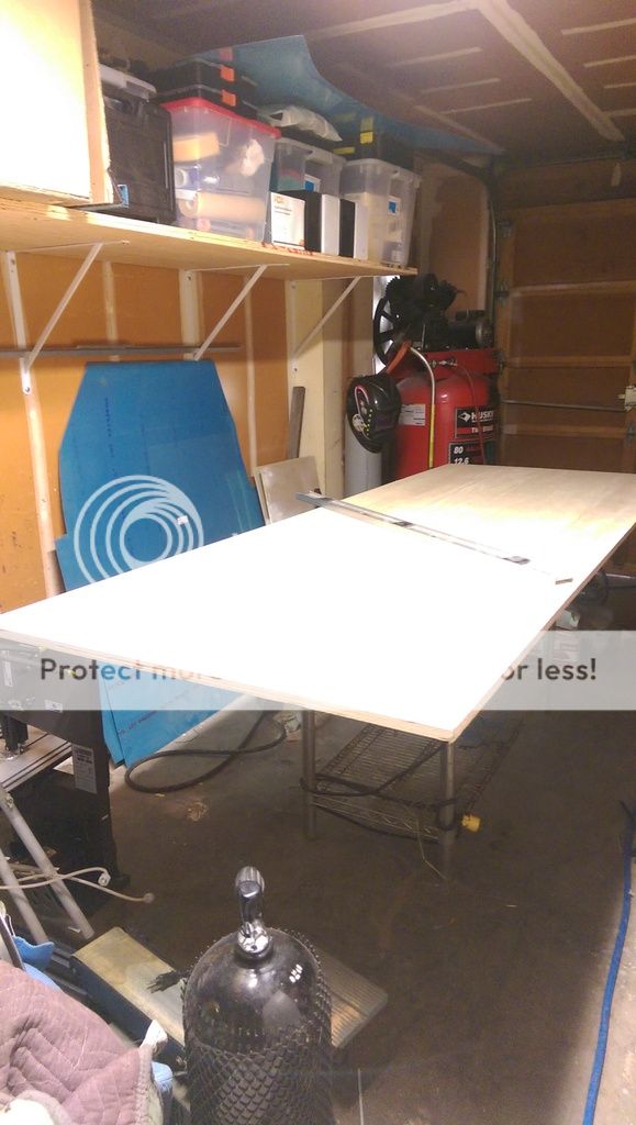

Building another table, have the room now that I freed up some space

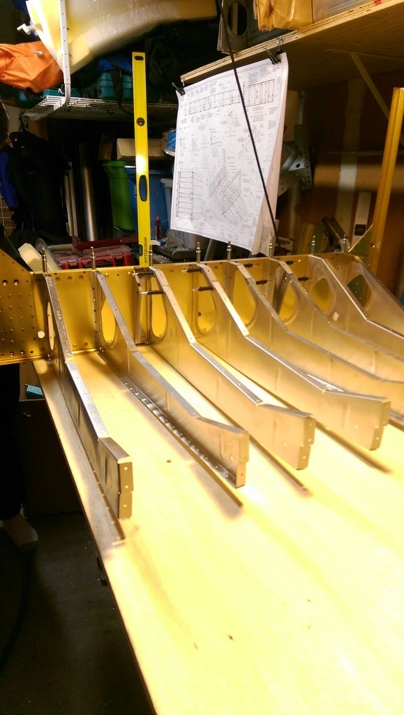

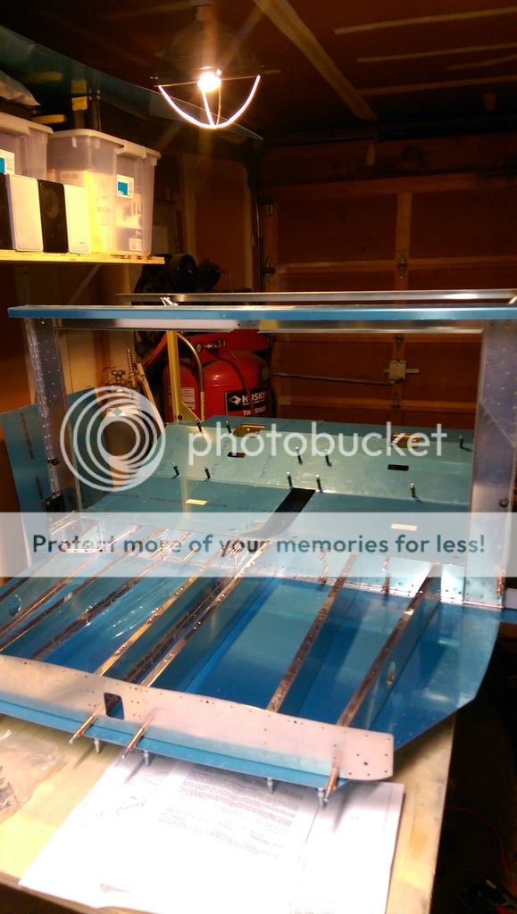

kentlik 02-02-2017 03:33 PM
HS almost there...

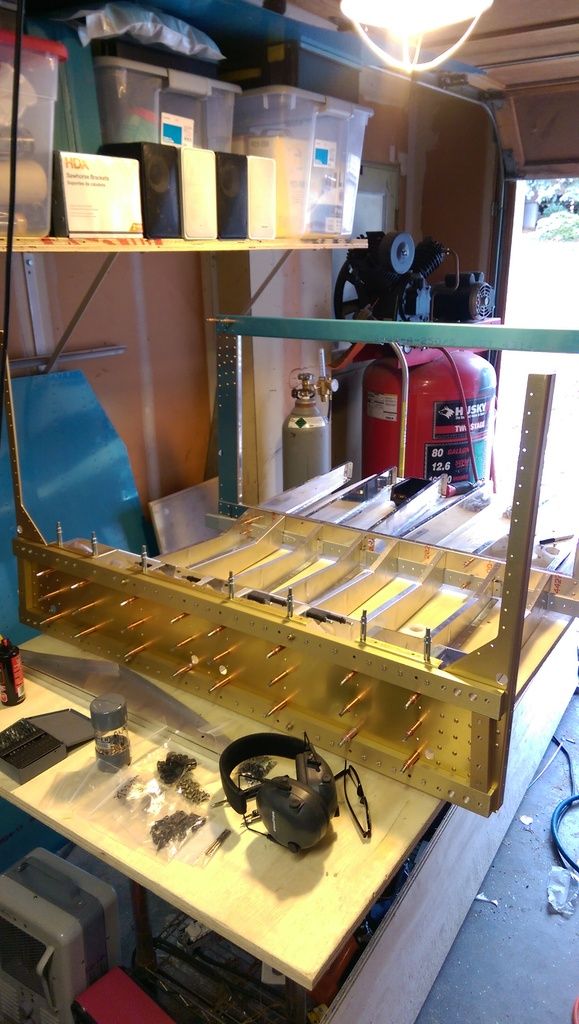

kentlik 02-04-2017 10:26 AM
Originally Posted by Blain (Post 1147114)
Nice. Glad to see you stuck with it.

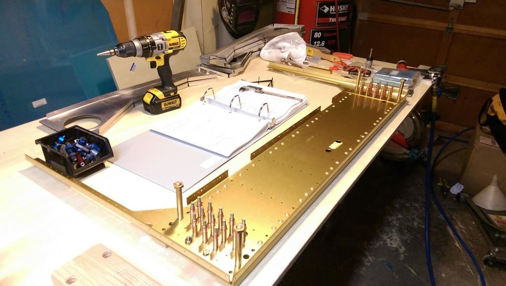

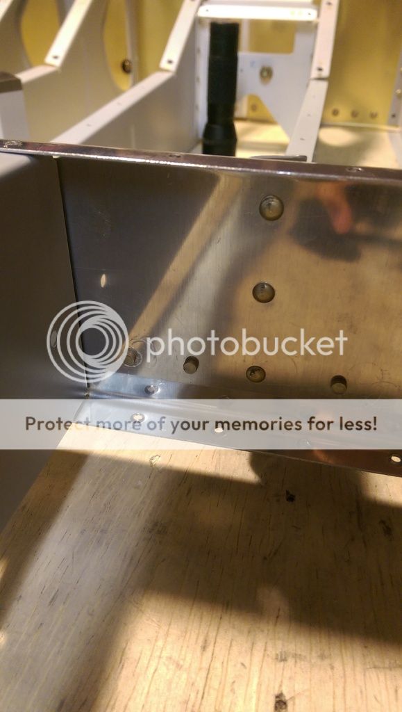

Thanks Blain. Building the whole of the center section just because most of it was FUBAR. I purchased a fuse package from Darrell and it has been nice to have all the parts I needed. As it turns out, it was most of them minus the three aft skins below the longerons. Still having fun!

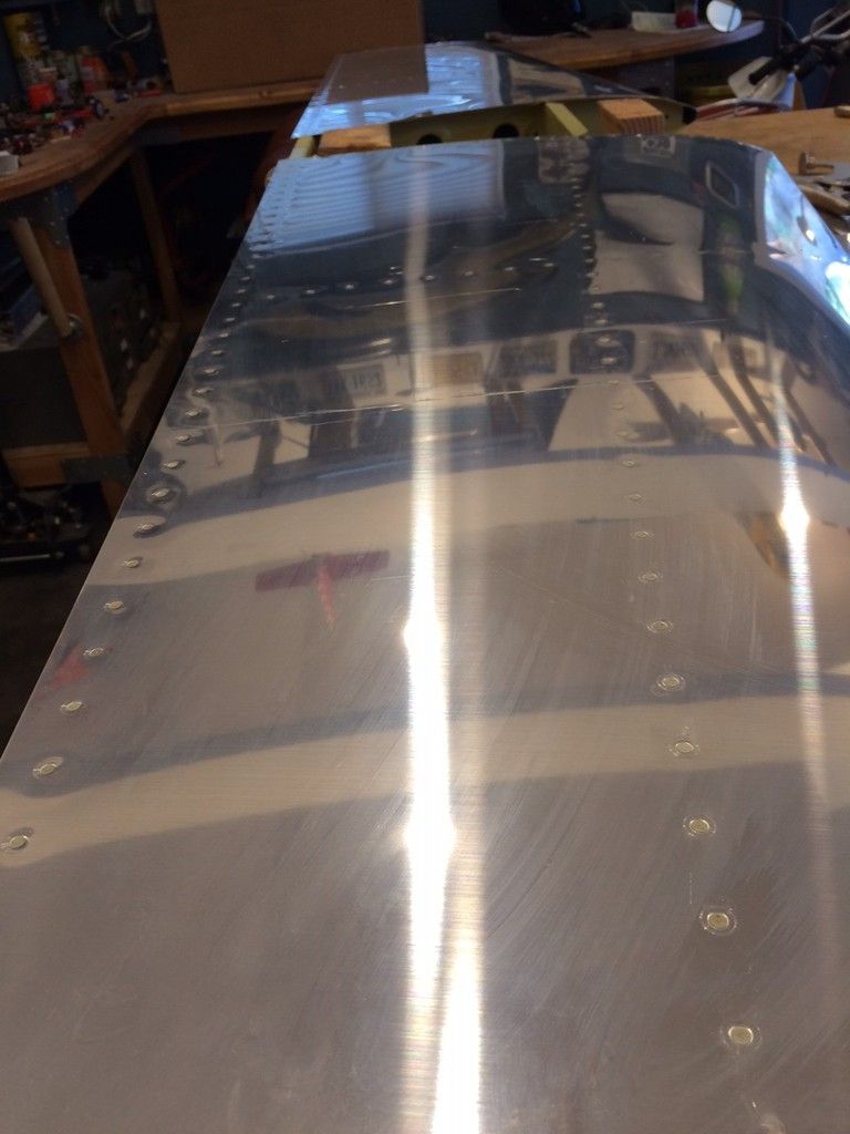

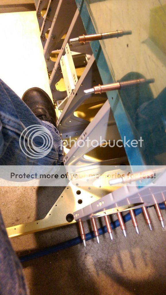

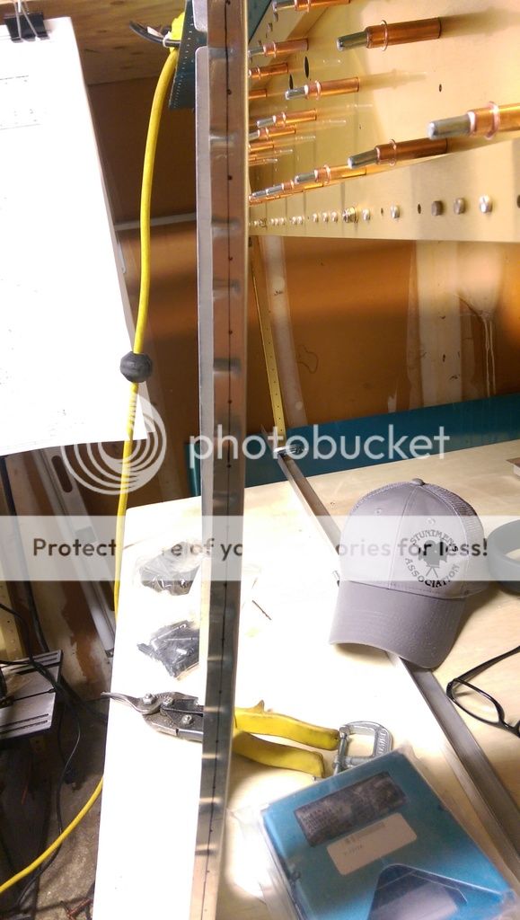

kentlik 02-09-2017 11:57 PM
I made some progress in the last few days. I like that this thing is like a big model kit, like the little plastic models I made as a kid in the '70's...but larger
