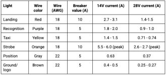

BTW, the actual peak current loads for each wingtip are:
Landing: 2.51A
Taxi: 1.65A
NAV: .69A
Strobe: 1.52A

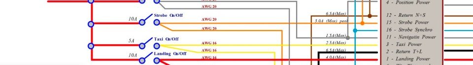

So reading the schematic from Aveo ….. do I have to run wire harness from rear position/strobe through module and plug 4 sockets into CPC… then run all wires out of front of CPC????
Doesn’t it make more sense to snip off the sockets and splice in the 4 rear position wires and then run less wires through wing???
Trying to understand schematic better
Not sure I understand what you are requesting
If this is the schematic, you are looking at I think pretty straight forward.
Assuming you are grounding at each wing tip and tail you only need to run 3 wires to the strobe/nav in the tail. Strobe power, Position power and strobe synch. There's only one "socket" per wingtip and I would not be snipping this off. Maybe show your wiring drawing, a hand sketch would be fine.
The ZipTips come wired internally; you don't have to do any wiring internal to the wingtip module. It comes with a CPC connector and pigtail that you connect your wires from the wingtip through your wing to your switches. It's a good package and well done.
The one thing I did was de-pin the pigtail connector they provided; their goal is to make it so you only have to splice to their pigtail - which is a nice thing, but I preferred avoiding the extra spliced connection and instead pinned my wires and reused the provided CPC connector.
Rear position and strobe wires
I do not mean the tail posi strobe … I mean the rear position light in the back of wing tip….. here is a picture of how I have things so far …..
The 4 wires from the rear position light need to be pinned into the provided CPC connector. (Check schematic for correct position) I haven’t looked at your videos but I think this is what you are asking.
