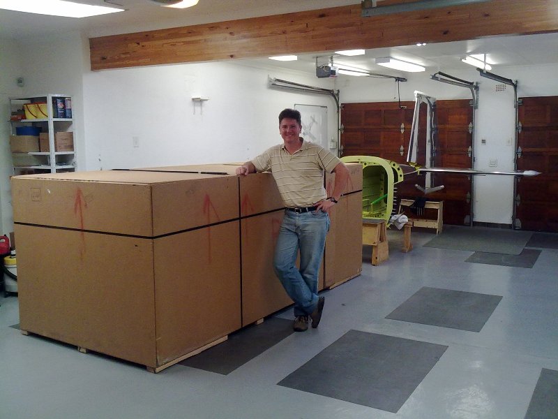

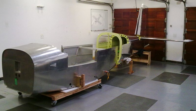

Xmas Father visit my Garage last night, he dropped off the QB fuse. Guess my namesake Rudolph, the Red-Nosed Reindeer and his friends was glad to get rid of this load off the shed.
PS: Without looking at the plans, how many hours of work is there on the QB fuse before I can join it to the tail in the background??
PPS: Can you see I am practicing my RV10 grin already??

There is very little that needs to be done to the front half prior to joining, but there is some stuff that is going to be easier to do before you join them.
I would make all the electric conduit runs now, it is much easier to get them under the rear floor boards.
Take a while to analyze what you are going to install in the tail cone------see the thread about ahrs mount for instance, and make any necessary provisions before you join the halves.
A little planning now could save a few headaches later.

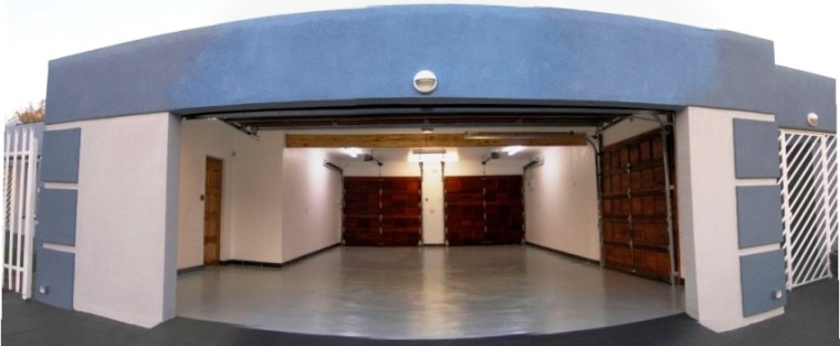

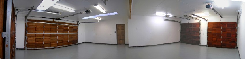

That is one of the cleanest "workshops" I have ever seen. Do you actually work there or do you import the finished pieces?
You're looking toward the door. Behind the camera POV is probably an environmentally condemned space where all the real work gets done... :p
Seriously, enjoy the new arrival. The shop (and that tail section) look very nice.

RE: CLEAN: He He :D you guys make me laugh. As you can see from the pics above there are no tools in the garage. The real manufacturing tasks take place in a small garage/hobby/room off to the right. Now that the QB is here the main garage is going to look very different very quickly. :p
Here are the link and some more pictures when I extended the garages in 2005 for the RV7 build:
http://www.rudigreyling.com/rv_garages.html
I made a quick dolly from the crate wood to maneuver the QB around.
