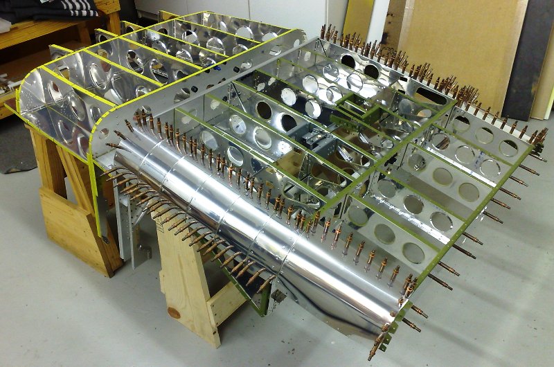

Rotisserie style, baby. And saves the back.
my.php
[/URL] By cnpeters[/IMG]
Yup....that's the ticket! Love the ease of getting at "everything". I should have put wheels on mine. I'm about to paint the fuse (will sure make it easier); then on goes the landing gear....so I can finially sit in'er.
