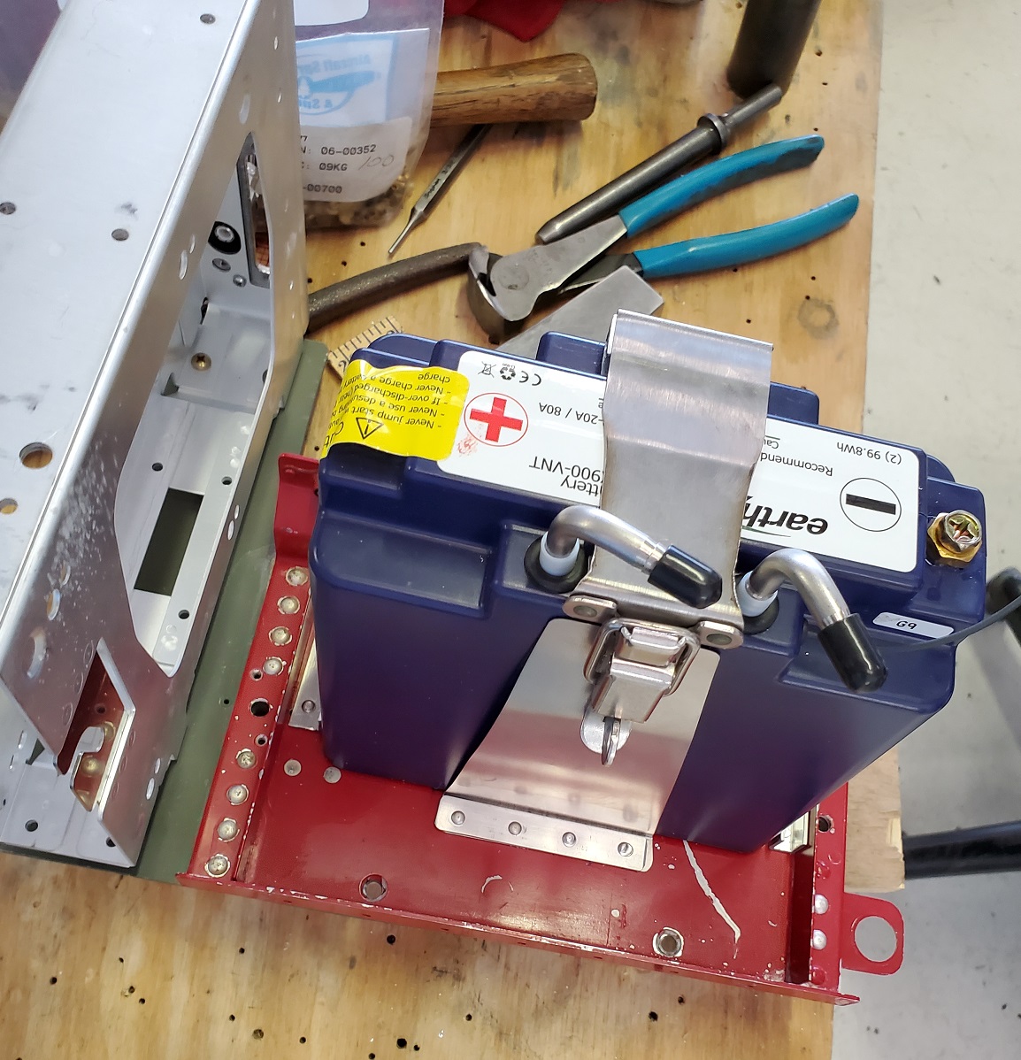

My RV-8 had the aft battery location with a Concord AGM aircraft battery. The airplane was down for a few months while Barrett Performance went through the engine. The battery didn't fare so well sitting around and had to be replaced. I opted to try one of the newer vented battery versions of the EarthX, the EXT900-VNT. I chose this vented model because of my battery location and wanted any smoke that might arise to be contained and vacate the fuselage. I added the optional EarthX vent adapter kit that takes both vent tubes and combines them into one larger tube. Included with this option is a machined vent port to send any smoke overboard.

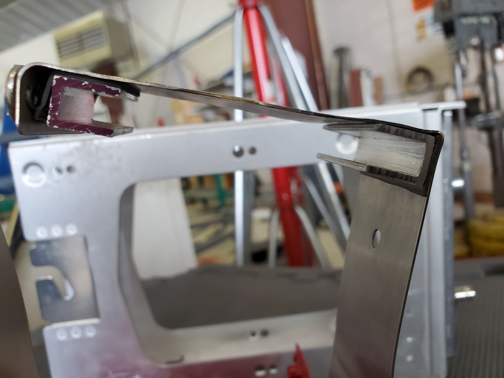

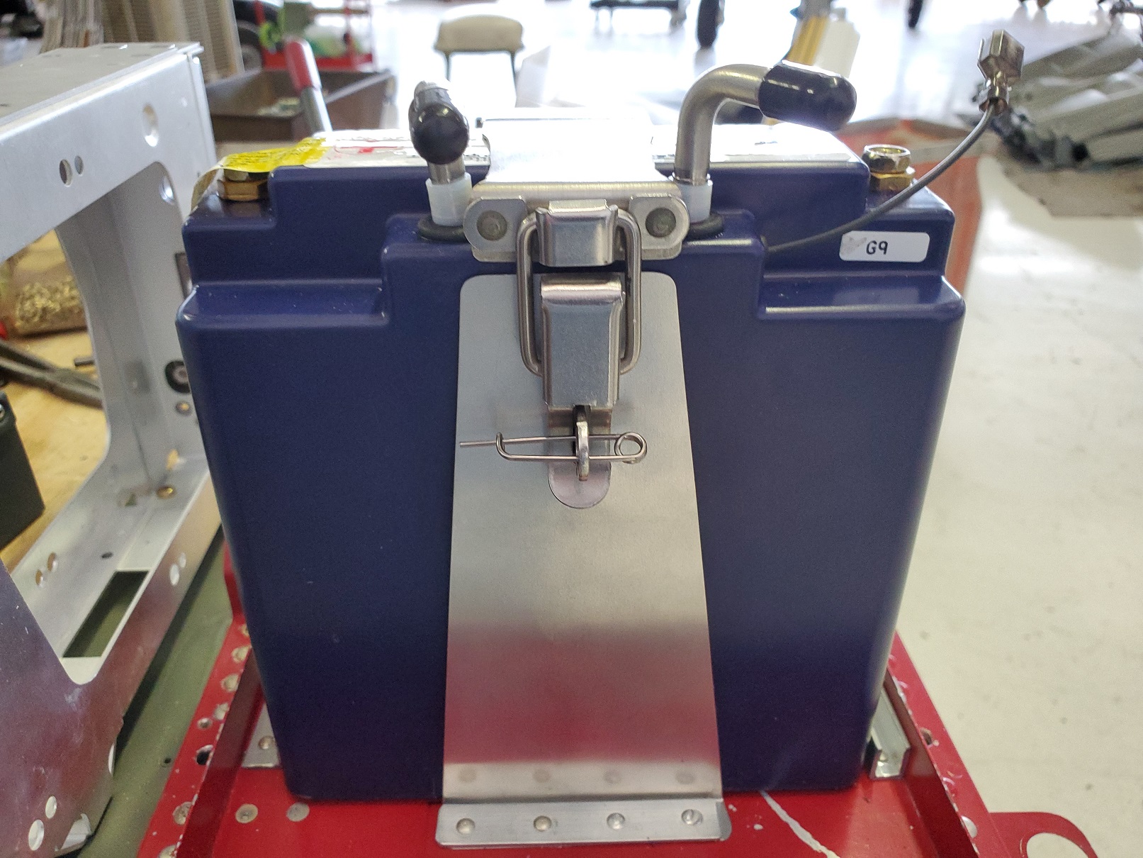

Since the new EarthX was much smaller than the Concorde I fit new spacers around the perimeter of the EarthX. I also re-purposed a stainless steel securing band and latch from an old Artex ELT to keep the battery in place. I cross-drilled a hole in the latch for a safety pin.
I bonded two channel spacers under the stainless band with 3M tape to allow clamping down the battery within the suggested areas in the manual.
Here is another shot of the hold-down set up from the front:

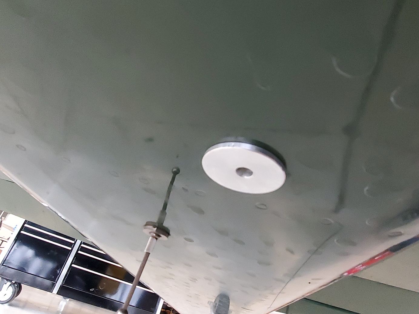

Here is a photo of routing the battery vent kit to the fitting in the belly of the airplane along with a photo of the exit vent fitting from below. It was convienient to use the optional vent kit. The special plastic tubing supplied by EarthX is designed for high heat and chemicals so it does tend to want to kink of bent too far:
Here is a photo of the end result prior to re-assembling the baggage shelf:

I used the supplied long bolts but moved them to front and back instead of to the sides.
I cut the long U channel and used the extra lenghts under bolted part so the top part of the battery case (where there's a seam) is not under pressure.
The vent is just behind the battery.
For the ELT, I used a cut-out from the instrument panel as a base, screwed on some angles that are riveted to longerons.
