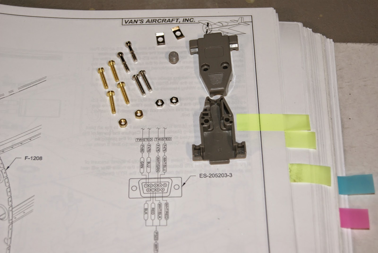

The screws that came with my ADAHRS were black ... when tested with a magnet, they were non-magnetic.
For what it is worth I also substituted brass screws and nuts for the hardware that attaches the clam shell coveting around the DB connector along with the two mounting screws that secure the connector onto the ADAHRS.
The brass hardware in the accompanying photo required some custom grinding down of the screw heads and nut surfaces on a Scotch-Brite wheel to make them the same size as hardware supplied with the connector.
