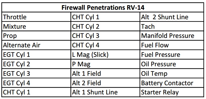

Will likely hang my engine in the next couple of days on my -14. I'm wondering if the two holes/passthroughs provided by Vans are enough to get all the wires through the firewall? Also anything I forgot?
I show a total of 27 items that need to be put through:
Just a few >
For starters, at least 4 - 20AWG and maybe 2 - 20AWG shielded, at least 12" FFW and 24" behind the FW for any future stuff. And whatever else you think might reveal itself in the future.
And, consider that for the Throttle/Mix/Prop pass-throughs may be better placed than where Van's allows for them. May need some of those eye-ball swivel pass-throughs or whatever you're comfortable with.
With that list, you will have plenty space with the two provided access holes. I would not drill any other or enlarge unless you really have many other things running thru.

Many thanks for the replies. Was just wondering if the two holes Van's provided was enough.

Can I add to this?
I'm at the exact same place. Just hung the engine, and now I find myself in a place I know almost nothing about. Mine is an 8, so if that makes a difference, I apologize for piling on.
I looked through this list (thank you, by the way!) and added three more things, Cabin Heat control, Oil Cooler Valve and Fuel Line. You repeated CHT Cyl 1, so by my count you had 26. I now have 29 penetrations.
In my mind, I have 4 categories:
Mechanical linkages: throttle, mixture, prop, Cabin heat, Oil cooler shutter and alternate air.
Fluid: fuel.
Power lines: Battery, E-mag 1, E-mag 2, Alt 1, Alt 2, Alt 1 Shunt, Alt 2 shunt and Starter.
Sensor lines: Oil Press, Oil Temp, Fuel Flow, Fuel Press, MAP, Tach, EGT 1, 2, 3, 4, and CHT 1, 2, 3, 4.
Fuel is by itself.
Since Power and Sensor do not mix well, that seems like two more penetrations.
Mechanical? I see the Van's holes for throttle/mixture and prop, so that's making me think the mechanical connections have their own penetration, or can they be grouped as well?
Am I kinda, sorta on the right track here?
Six holes total
I have two 7/8” holes for every wire except big 6AWG main bus wire. Then, one for throttle and mixture, one for cowl flap and one for alt air and prop. The alt air prop is a double eyeball as is the throttle mixture.
This is not an EXP119, correct? The EXP FWF kit should come with a third, eyeball-style passthrough for engine control cables. It gets installed just below the existing one on the right side.
Correct, this is not an EXP199. Just a plain old IO-390 Thunderbolt. You might catch Clay's post above...looks like I had one too many lines as I put in the CHT for Cyl 1 twice. Total penetrations are 26. At this point, I appear to have enough room but haven't finished all the wiring yet.
Yes, my understanding is that the EXP-119 needs a third penetration for the throttle cable.

My current pass through items list has 34 electrical items on it. I currently have 2 1" pass throughs, but I purchased a third which I plan to mount. I do have a couple of misc. temp sensor wires I added.
The thing you have to realize is some/many of the items are more than one wire. EGT/CHT are 2 AWG 20 wires for example. Some sensors are 3 wires.
I used AWG 20 for all wires that go to the engine for my firewall mounted items I used AWG 22. You can follow whatever you feel comfortable with.
