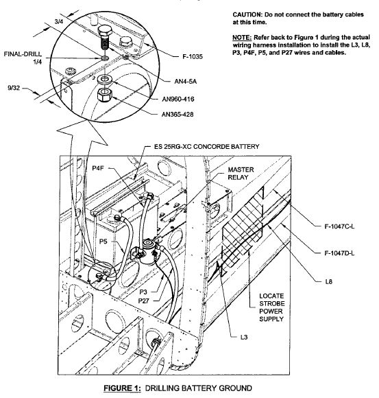

RV-10 w/60 amp alternator,
Can i simply ground to fusalge on (-) side of battery? Or do i need to run the ground to panle & Engine like ol knuckles(sp)says to do.
I was going to use a 4awg wire.

You can, but I believe most run the ground wire to the firewall. I'm using a #2 welding cable, although a #4 should be fine for most. It should be the same as the positive power cable.

I grounded mine next to the battery with a #2 cable, just like the Van's wiring harness plan shows.
Me Too. Much like virtually every 12V, neg grd, metal vehicle ever produced.
Rleffler and all
Thank you very much. The diagram and pictures were very helpful. I never could read books without pictures :)

#2 wire and ground the battery on the mounting plate. I will be visiting B&C after this post, next time I drive by Joe Pool Marina I will pick up one of those thur post for the firewall that looks like a great way to carry power to my main bus
