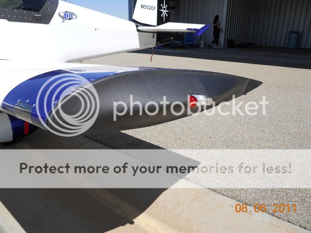

One tip on your wing tips
Configure your wing/wing tip interface with forethought so you can easily remove them. Wing tips are fairly easy to develop and the differences in performance (speed is all I care about) of any reasonable design is small. So far my fastest design is a straight streamlined design with the plan view shape defined by the shape of the lower surface of the wing. The span of each tip is 3". Stock on my RV-6A is 12". I also built and flown it with tips of 0", 3/4" and 21" span.
Bob Axsom
Hey bob,
I followed all your work before making mine. In the end I just did something that made me say "Yeah", I like that. I've only flown for 7 hours so far. I don't think their slowing me down so I'm cool with them. Your efforts in my design are most appreciated though. I'll make you a set if you want for whatever reason if you like. I really did follow your trials. Thanks, Chris.
No more tips exactly
I think I have found the best for the stock wing. We in the Axsom household are dealing with a major problem that prevents me from doing anything about the airplane right now but the mind never stops thinking about it. Should we survive God's latest challenge I am planning to reduce the stock wingspan by one rib bay on each side. It is not as risky as it sounds since my tip tanks add 9" inches back on each side (1.5 feet total). The idea is to have three configurations (1) tip tanks and stock tips with lights, etc. for travel and 55 gallons of fuel, (2) Long range racing tip tanks & 3" racing tips, (3) short range racing 3" tips only. I still have the flat tips that I may experimentally try with tip plates of decremental size to find the best size. This last one would be to confine the flow over the greatly reduced wing and reduce the angle of attack (induced drag) by more than the parasitic drag of the tip plates.
