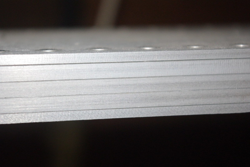

I am attaching a couple of pictures of the spar edges that show all of the shear marks - each of the layers of aluminum is sheared different and are not all the same size either by slight amounts. I expect that it does not matter from a structural integrity point of view but I was concerned with how it looked and the overall roughness. After viewing some of the great 12's that the guys brought to our get together Saturday at Bremerton, WA I decided that I was going to at least do some filing to get rid of the roughness and make things look better. First two pictures are of the as received condition. Last picture is one of the spar edges after I filed the roughness to a reasonably smooth level and then primed.

Man O Man!
Those shear marks are really ugly - wonder how they escaped QC? I don't think that I could live with those without doing some serious and careful filing - like, even more than you did. Think that I'd have to make up a jig in order to make the filing precise. And maybe use a power sander in the jig. I'd really like to see a smooth and regular surface without reducing the dimensions.
Hope that mine aren't like that - I have a much earlier kit. I'll look at mine when I get there - hopefully this year! Maybe Van's cutting devices need to be sharpened or replaced?
Shear marks
Shear marks they look like they were cut with a chainsaw.
It's hard to take pride in your workmanship ( if ) vans thinks that's OK
The gaps in the lay-ups concern me.
I would rather assemble the spar myself if that is the best they can do.
Those shear marks are really ugly - wonder how they escaped GC? I don't think that I could live with those without doing some serious and careful filing - like, even more than you did. Think that I'd have to make up a jig in order to make the filing precise. And maybe use a power sander in the jig. I'd really like to see a smooth and regular surface without reducing the dimensions.
That's a pretty rough finish to say the least. Maybe they have changed their manufacturing process, but this is my spar as delivered in 2010. Big difference. Did you send Van's those photos?
My spars came looking much the same as the photos posted by John H, nasty undressed edges from the shearing process ? the ?chain saw look? as Joe so eloquently put it. In fact, think mine are a little worse looking.
Overall, I?ve been impressed with the quality of the fit and the excellence in the packaging and condition of the parts in the RV-12 kit. However, that said, the spar is one area where Van?s has truly dropped the ball in my opinion. It does not seem to me it would be that difficult to at least knock down the big stuff at the factory before anodization. It doesn?t have to be perfectly smooth ? but gee, at least dress it up to the point it won?t rip flesh.
Just a comment on the lamination issue - I don't think that there is any issue there. My photo looks like there is a gap but that is because I took the shot at and angle and the fact that each of the layers is not exactly the same in width causing one to stick up more than the other. You are seeing the dark line becasue of the height of the layers versus the gap between layers. I considered filing/grinding until they were all even but in some cases that would result in filing down the outer top layers since some of the inner layers were lower. I decided to make them look better but not modify them substantially from what I received that was supposedly ready to use.

I'm not impressed, Joe - John's pictures look ghastly! John thinks so too, and since I now know where John works, he's well qualified to hold that opinion.
If nothing else, there's that ugly enemy of quality - variation - poking its head up again. We have U-channels with shouldered holes, and U-channels without shouldered holes. We have wing ribs with plastic covering and wing ribs without plastic covering. Now we have laminated wing spars that are smooth and spars that are rough (very rough!). I would be very hard pressed to put that in my airplane, call it a "finished surface", and hold my head high with pride. And what about the machining chips in the cavity???
Fortunately, mine were smooth (Kit #302).
