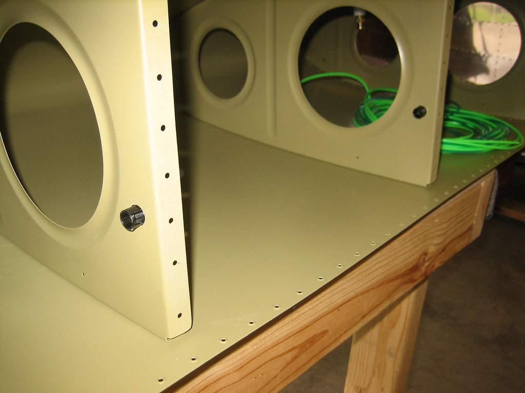

I used the smaller 1/8" holes in the wing ribs, installed a snap bushing and ran through there. You should be able to see some pictures of it on my builder site under the wing section.
Here is where I put mine.
AFS Tubing
I ran the AFS tubing down the same holes and the pitot line uses but in the rt wing. Pitot Lt wing along with Stall warning, and AFS AOA in rt win
Work well have not had time to update builders lig but shoot me a email to
[email protected] and i am more then willing to send you pic's
