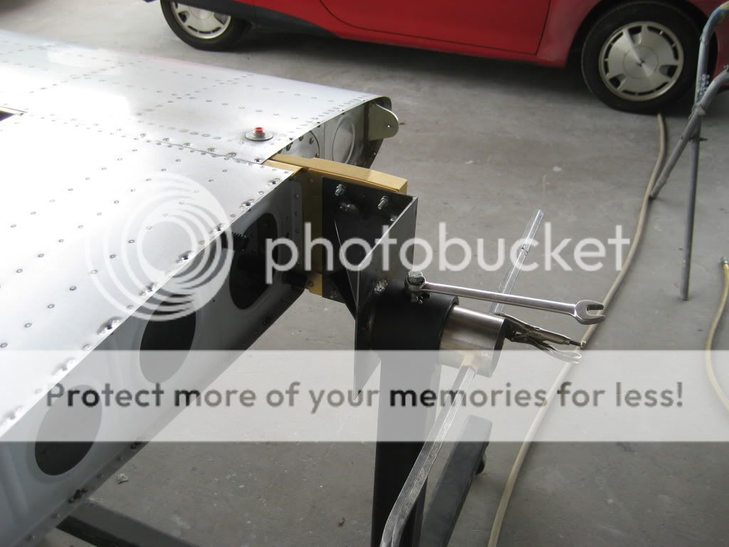

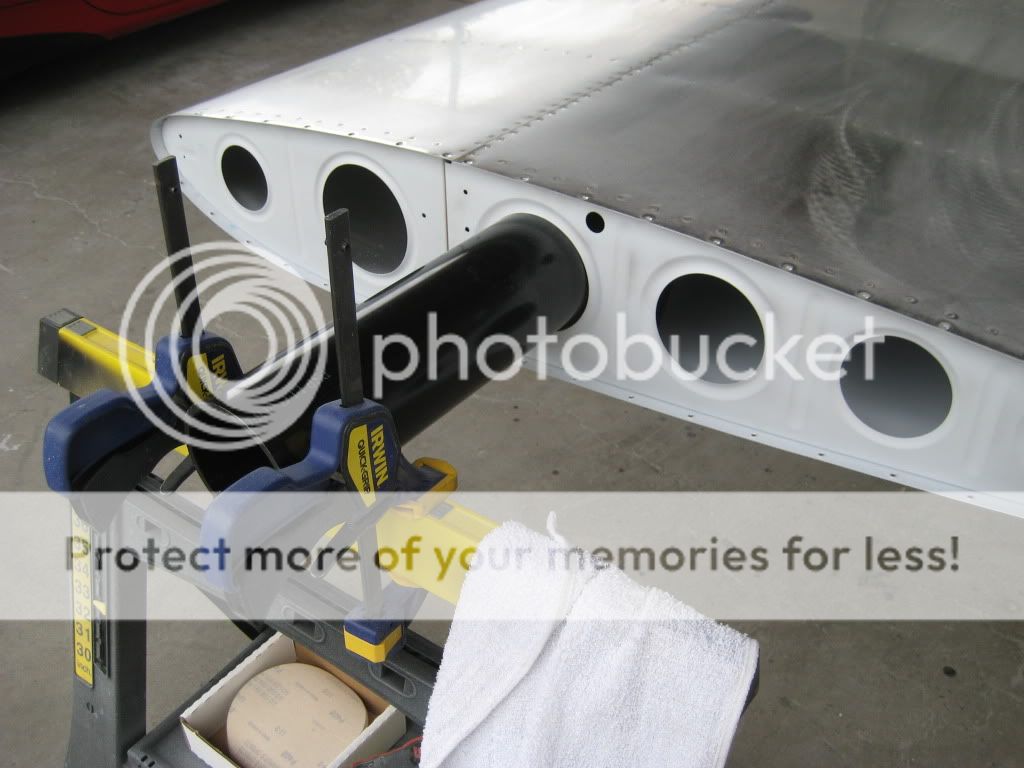

J JakeLewis22 Well Known Member Jun 16, 2016 #2 Wing Rotisserie I used an engine stand with a fabricated adapter on the inboard end and a length of ABS pipe with a sawhorse on the outboard end. The pictures tell the story.....
