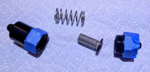

Hi Steve - I just installed the Retrofit version of your wing root fuel filter kit in a -flying RV-14A. Very straightforward install, and it feels rock-solid (no movement once adel clamps are tightened).
I have one question: these filters don't appear to be serviceable; are you recommending that we replace the Holley 162-562 filters at each condition inspection? Or, is there an easy way to clean the filters?
Alex
Alex this is Tom. The Holley filters ARE serviceable, just unscrew the end, and the filter comes out.
Tom
