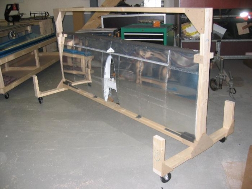

OK, I shopped long enough for a wing rack plan, now I need to have one NOW. I don't want to do a generic rack, but one expecially for my 12 wings. I feel that with the extended spar, one end should be supported by the spar, the other end in a sling, to put less weight on the nose of the wing. Does anyone have a photo or link to one that they made or has worked out well for them?
Don, your RV-12 wings work well in the standard RV wing rack. Build them and they will fit. ;)
The horizontal stabilator will fit between the wings in the standard wing rack;
