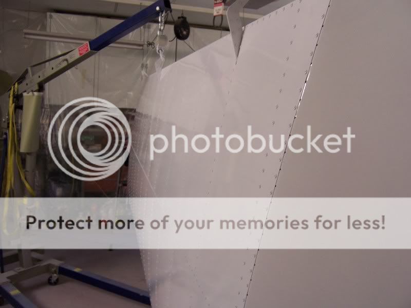

Used an engine hoist, and put a pin thru the center flaperon bracket. Could raise and lower as needed. Held main spar in 3 step ladder to stabilize.

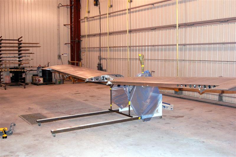

Abbott Aviation, Aurora, NE (Top Gun Aircraft Refinishing) converted a rotisserie fuse rack just for the RV-12 wings to be able to paint the bottom with a roller chair. It uses pins just like the plane. The painter likes having the surface flatter rather than upright. Made it easy for fiberglass tip prep, and to acid etch and alodine, and to move around the wings while painting.
