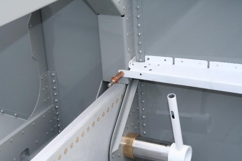

I just tried to fit my right wing the the fuse. for the first time. With about 3/4 " left to go, it stops. I can't see where it is hanging up yet, but I suspect the main spar near the 1st rib. I was just wondering if others had these "hang-ups" also and where they occurred?
I had the same issue, trimmed the openning in the fuselage skin slightly. The rivets on that first rib were catching.

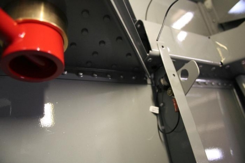

I had problems with the bulkhead cabs. It was hard to see but after trimming the bulkhead cabs 1/8" the wing went in smoothly;
MyKitlog1
Mykitlog2
Before trimming;
After trimming the bulkhead cabs;
