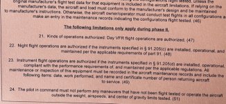

What is the ACTUAL wording in your OpLims? Specifically.
Now I'm really confused. I've never actually looked at this as I have been told with the utmost certainty that the RV-12iS is NOT eligible for IFR flight yet right there in #23 it says "Instrument flight operations authorized..."
The standard OpLims changed about 4 years ago, as best I can tell.
I haven't decided if I'm going to go with the Garmin IFR Avionics package, or the Dynon and add the GPS-175 after. Going Dynon will be cheaper, but I won't have a NAV receiver. I already have my Instrument rating, so I don't need the NAV for the test. And I would probably never use it. I only want to be IFR equipped for getting above/below the clouds here in SWFL. No intentions of doing hard IFR.
Agree 100%
Anywhere I have ever used an ILS approach there were RNAV with LPV approaches available. As far as flying a route you can always flightplan using the VORs as waypoints so you will follow same path. I really see no need for NAV in a light plane that I will never take into hard IFR.
This past Friday I had to divert from a direct path and also change altitude twice to remain clear of light clouds. With IFR authorization I could've maintained my planned route and altitude staying in cooler temperatures.
See this post: https://vansairforce.net/community/showpost.php?p=1193331&postcount=25
And the rest of the discussion in that thread. In 2013, it wasn't allowed. The standard OpLims were changed before 2017.
So my understanding is that if I have all of the equipment needed and it is tested, operational and I am a rated IFR pilot, I should be able to fly into IMC conditions. So, an ELSA 12IS with proper IFR equipment can be flown into IMC. Again, my personal minimums would not allow hard IFR. But that low layer that just will not go away is something I am comfortable with if no icing. But it's also nice to have if the TAF is a liar. Common in the PNW.
I've read other articles about this and not sure why it is such a question with so many polarized opinions. Sure SLSA might be one thing since it can be used for hire. But I have yet to see an FAA reg that limits IFR in ELSA as long as it has all of the required equipment outlined in 91.205. I'd want to add a heated pitot which it sounds like several people have done.
As before, check your OpLims. If they don't allow it, you should be able to get them changed.
… But I have yet to see an FAA reg that limits IFR in ELSA as long as it has all of the required equipment outlined in 91.205...
And you will not find such a regulation. LSA in IMC is restricted by ASTM standards which define what an LSA is. The FAA takes no position on it but the ASTM (as of today) requires placards in LSA which state that flight in IMC is prohibited. It does not say flight under IFR is prohibited, which is why IFR flight training in VFR conditions makes the properly equipped SLSA a wise choice for flight schools.
It has been years now since this ASTM rule was adopted and may hopefully change one day but for now, watch those cloud clearances, your ADSB out is watching ;)
The ASTM rule applies to S-LSA. E-LSA don't have to abide by them after certification.

Read all the linked threads. Read your OpLims. Do they refer to the ASTM rules?
No but ASTM rules apply to all aircraft identified as LSA. There is also a placard on the panel that states no flight into IMC because of the ASTM definition of LSA.
As much as I want it to be true that I could rip that placard off the panel and replace it with a GPS175 I believe it the ASTM rule applies.
