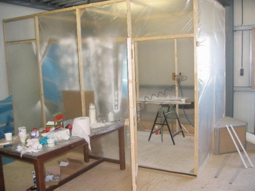

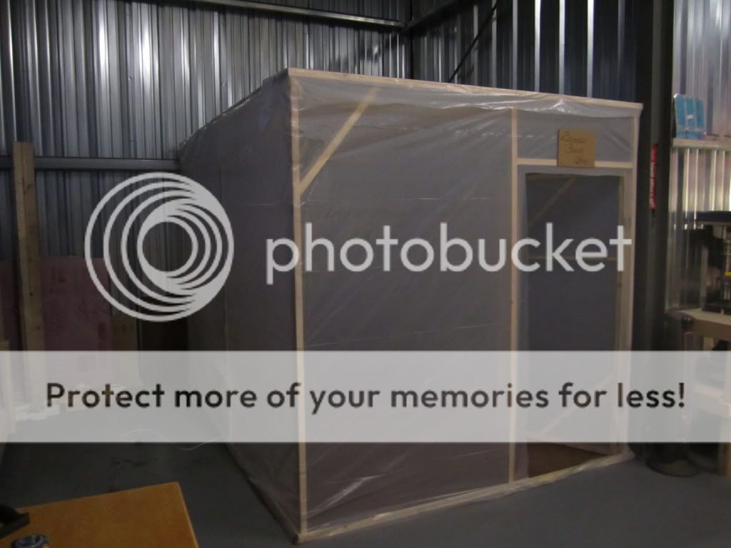

Depending on the weather for priming is a big issue for me (northern England ...), so I'm currently building a small booth.

In the paint booth of course. Very Easy to build and also very cheap. I have 2 fans pulling air out of the booth, both have Standard Air Conditioner filters on them to clean the air before it gets blown out, you still have the smell but at least the air is clean.

For alumiprep and alodine preparation I do it outside. Large parts like skins I paint outside, so that is seasonal and weather dependant work. I built a small indoor spray booth about 2-1/2' x 3' x 4' high out of wood, mounted furnace filters at the rear and used an old central heating furnace fan to draw air through the booth and filters then exit outside the house. This works pretty well using epoxy primer. I leave the fan running after I have finished painting until all the odour is gone.
