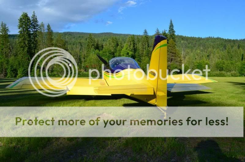

Paint first gets my vote. Wings were painted in May 2010 and hauled to the airport. Fuse and everything else painted Aug/Sept 2010. Final assembly October 2010. first flight dec 2010....oh yeah...its car paint and was told it would never hold up.
Here it is at Cavanaugh Bay taken this weekend (3 years later) looking like it came out of the shop recently. I have a chips or two...but very few. My hangar mate threatened to whack it with a ball peen hammer, just to make it look normal.
