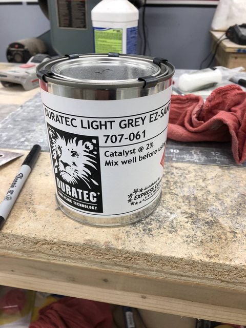

I have purchased, on a friend's recommendation, a quart of Duratec sandable primer, with the intention of using it on the composite parts of my -10 build and the feathered transitions between epoxy resin and bare aluminum.

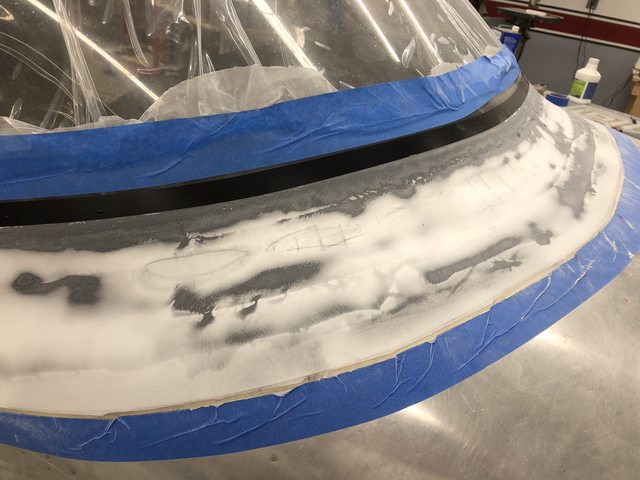

Before I applied this to my windshield lower fairing, I had planned to pull the electrical (vinyl) tape off the plexiglass and apply a new masking strip just a millimeter or so away from the sanded edge of the fairing to allow the primer and paint to lap slightly onto the plexiglass and over the edge of the fiberglass layup. This means a very narrow band of contact between primer and plexi. Instructions on the fairing layup specifically call out epoxy resin (I used West) because polyester and vinylester resins are not compatible with the plexi.
I don't want to craze this windshield, obviously, so am wondering if I need to abandon this product in favor of an epoxy filler-primer.
If I don't use the Duratec near the plexi, can I still use it on the other fiberglass, such as canopy, wingtips, cowl? I'm not sure how to blend (or butt) this stuff with the epoxy primer I will one day use on the sheet metal prior to paint.
Even with a complete build under my belt 20 years ago, this is one area I'm really not feeling too confident about.
Thanks for suggestions.

The Duratec is advertised as a high build primer as well as a mold surfacer, so I presume that was why the poster got it as a recommendation.
As far as durability goes, the Prestec finishes are usually used as a replacement for the original German gel coats. Those are the ones that created the need for refinishing.
My experience from refinishing my sailplane with Prestec products is the finish is still great and polished after 33 years.
As far as my plans for the interior of the RV-10 cabin top, I have purchased the JetFlex composite primer since I intend to use the one-part JetFlex WR polyurethane product. I'll report how well that works since the cabin top interior of my old green cabin top is pretty cra*py and will need a lot of smoothing work..
To answer DanH's question, it was recommended by some fellow -10 builders for ease of use and good results, at least short term, and above all availability in single quart qty from the supplier. I'm not sure how I'm going to like the relatively short pot life in the gun (15 min max, I'm told) and may end up rolling it on.
I have done extensive finish sanding of all my composite exterior surfaces with 400 wet over a squeegie coat of neat epoxy and feel like I probably have the surface trueness and pinhole filling I want, but I know those are famous last words. I'd feel better with a protective coat of something sandable on there before I move on to other aspects of the build in case some grease/oil contaminants find their way onto the composite pieces during the rest of the build.
The question remains - whether it's safe to let this stuff come in contact with even a 1mm wide strip of the windshield.
