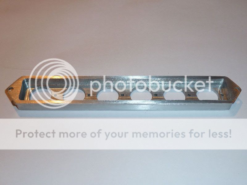

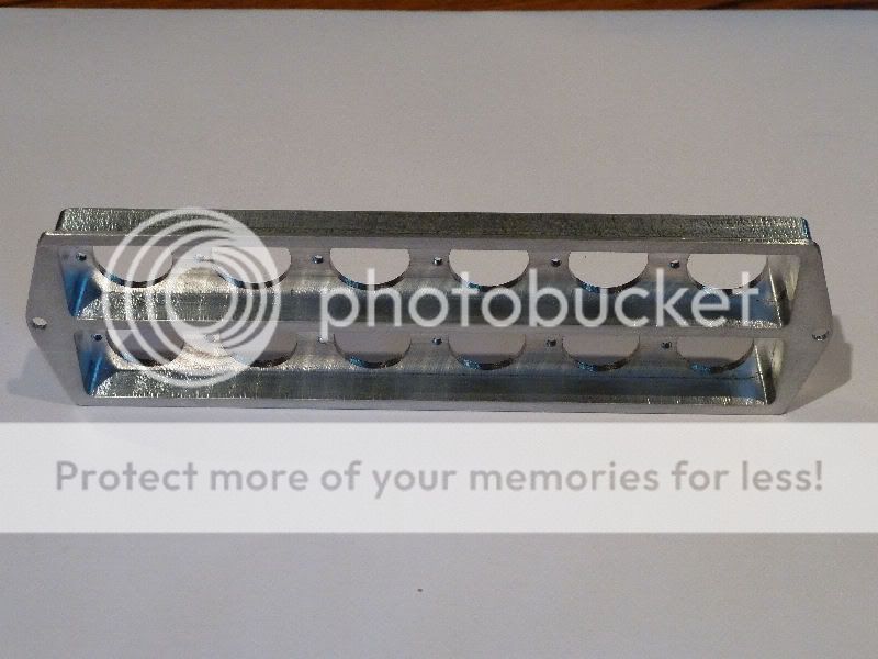

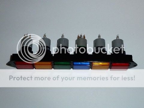

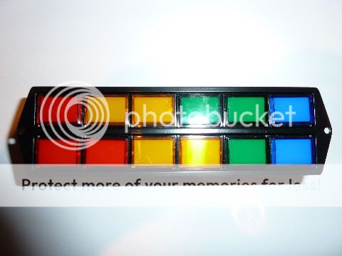

Out of interest, I have made a few Annunciator panels that use EAO type 31 switches and lamps.
I CNC mill them from billet aluminium and can make a variety of shapes if anyone is interested then pm me for details.
John
The small one is 6 1/2" (165mm) x 1" (25.4mm)
The Larger one is 6 1/2" (165mm) x 1 13/16" (46mm)
I built an annunciator panel using the lights shown in the above post, that contains the following lights
Master Warning - driven by G3X
Master Caution - driven by G3X
Alternator - driven by plane power alternator built in circuit
Oil Pressure - driven by independent switch obtained from Vans
Door Ajar - driven by 5 mechanical switches through a relay
In addition, all these same functions are duplicated on the G3X EFIS
