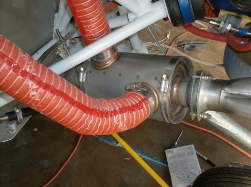

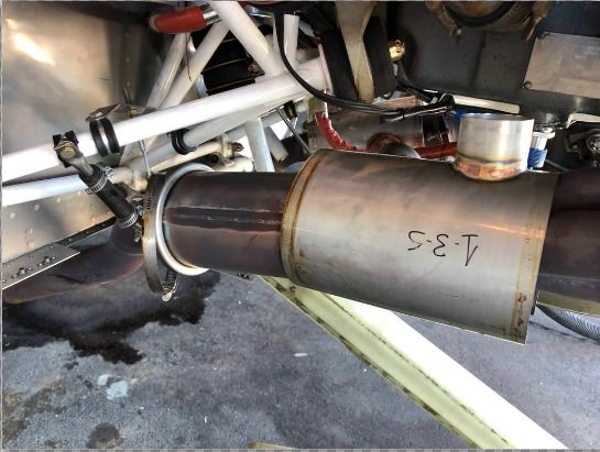

Here's the only picture I have right now. From when I pulled it all apart, the heat muff is obviously slid forward in this pic.
The muff did not have any restrictors in it like I've seen some others have.

I don't think so -- we're not kidding about the quantity of heat the system puts out. You can not fly with the system fully open for more than a few minutes -- I kid you not.
I can't tell from the picture but they didn't ceramic coat the exhaust or something did they?
Lynn
There is one on each side. This is just the right side.
Interesting. My muffs do not look like that hence my confusion. My SCAT connections are not in line like the ones in your post, they are roughly 90 deg apart: the forward one is the inlet from the baffle vent and the aft one goes to heater box. Also my muffs are shorter and fatter. Here's a pic of my right muff (the left is a mirror image).
:cool:
Yes of course. The muff was just rotated so you can't see the exit in the picture.
