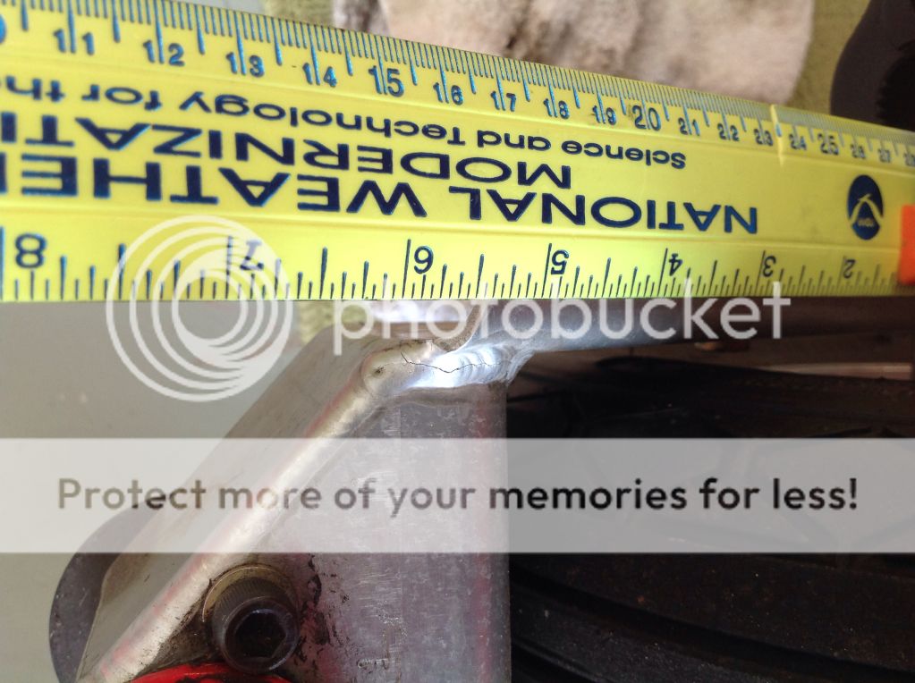

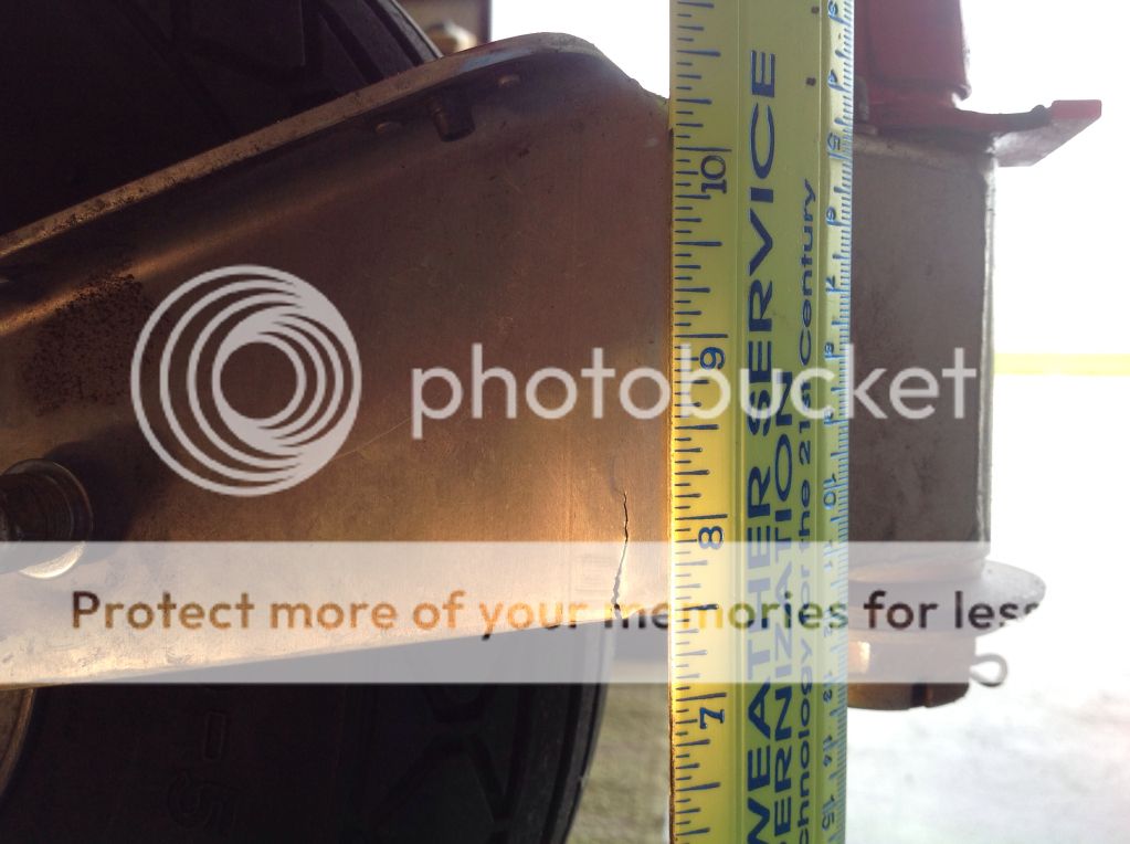

RV12 First Flight June 2010. Total time airframe 558 hours. Plane used extensively in transition training. Hundreds of takeoffs and landings. Vans has been notified and has seen the pics.
Observations!
IMHO there is no flaw in the design, just what you would find in a training environment. The info posted here is for other RV12 pilots to think about and watch for if they let their nose wheel plop down over many many landings versus holding the nose off as in a SoftField landing and continuing to hold the nose wheel off as long as possible until Horizontal Stab lift is loss due to low airspeed on roll out. Again this technique for both Takeoffs and Landings will make for less stress and lower maintenance over the life of the Aircraft. Also think of the damage that would occur to the Aircraft if this had not been found prior to complete failure. Furthermore I recognize that in certain weather conditions that this technique may not be feasible.
You make the Call
Front top right side of nose fork.
Lower front right side of Nose Fork. Ruler included in pics for scale.
