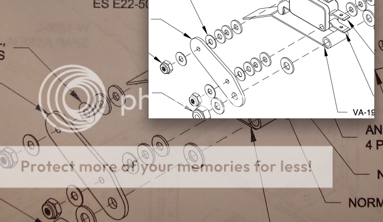

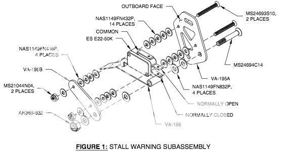

Different washers since revision
At 23/02/2009 there was a revision of page 16-02.
Step 4 now calls for NAS1149FN432P and NAS1149FN416P. I assume the 432P are he thick ones, but they were stored together in one bag and I can't find the specs of these washers.
Figure 1 says to use 432P at 14 places but 16 are drawn. Does anyone still remember what he used?
The second picture is from Tony. Total washers are hard to tell due to the shiny aluminum (please prime it next time Tony;))
I guess it's not critical but if someone remembers it will save some time.
Thanks, Joeri.
Update
432P=32/1000 of an inch, 416P=16/1000 of an inch. Simple but I didn't know that.
Besides that I was confused by the drawing showing 16 432P washers and the text saying to use 14 washers. In Slane's blog there is a picture of the stall warning with the "old" page before the revision. In the revision one washer is added without updating the text. Not really important but I mailed Van's.
Below a picture of both versions. The white insert is the last revision (four washers instead of three between the micro switch and the alu plate).
This update must be very new. I received my kit in June and has the old drawing. Without the additional washer you can not tighten the nuts for the vane won't move. Indeed it is very hard to separate those washers. I use a caliper to separte the thick and the thin ones.

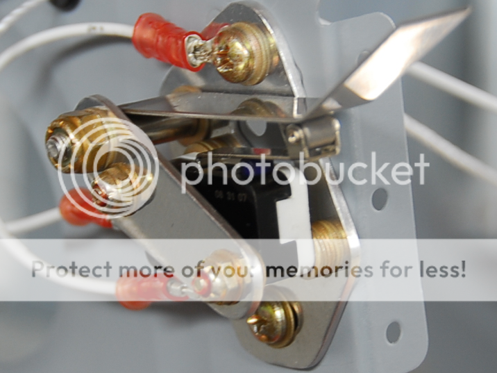

Built my RV-12 stall warner today and for a little job it took at long time about 4 hours in total including researching the plans confusion with the washers required. I also took about 3 attempts to get the micro switch to work with the skins fitted and pleased to report it does now.
I decided to take plenty of photos for future builders that will hopefully help and they start here on my website.
Thanks all
Jason, the pictures are very nice to have - thanks for them. Did you have to change anything when you put the skins on? If so, please tell what changes you had to make. Thanks again for the pictures.
I had to bend the micro switch a little when test fitting the middle skin to get it to work. I will double check it still activates and make any adjustments when I fit the skins properly as I suspect despite the access panel you'd need rather flexible small hands to actually remove / refit the switch so it's gotta be right from day one.
