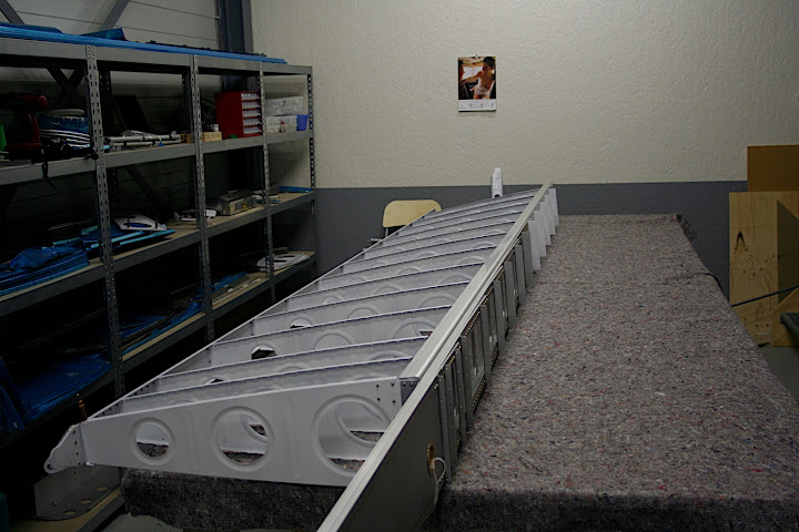

W-1210B-L Does this look right?
thomasyost
Member
I noticed where the W-1210B-L doubler and W-1210-L Main rib attach to the spar attach angle, it looks a bit odd to me.
lw7ifbyq-lrgzeEod1xedg
It seems to match the insert picture of Figure 2 on page 15-04.
Looks correct. You end up with a gap between the doubler and the attach angle.
I could only find the next picture. When you zoom in it's not sharp but it looks the same;
Left wing
