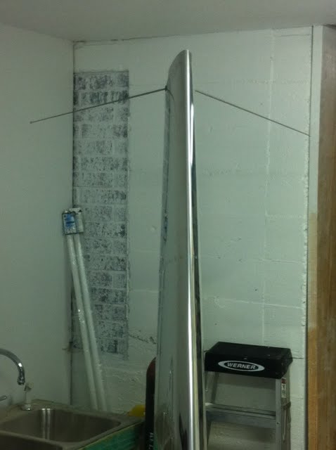

I am looking for some photo documentation on how the small minority of RV-10 builders out there installed their cat whisker VOR/GS/LOC antenna on top of the VS.
I have found a few random photos from airshows and can tell that it has been done, and appears to be done well from a distance. There are a couple of threads on this site with build photos from smaller RV's that have been helpful. I am trying to locate the puck with minimal/no protrustion through the tip sides.
One photo in particular had the traling antenna arms below the travel of the rudder. Of course, I am trying to retrofit a completed tail so it may prove to be futile without major disassembly.
Any information is greatly appreciated as always.
Thanks in advance!

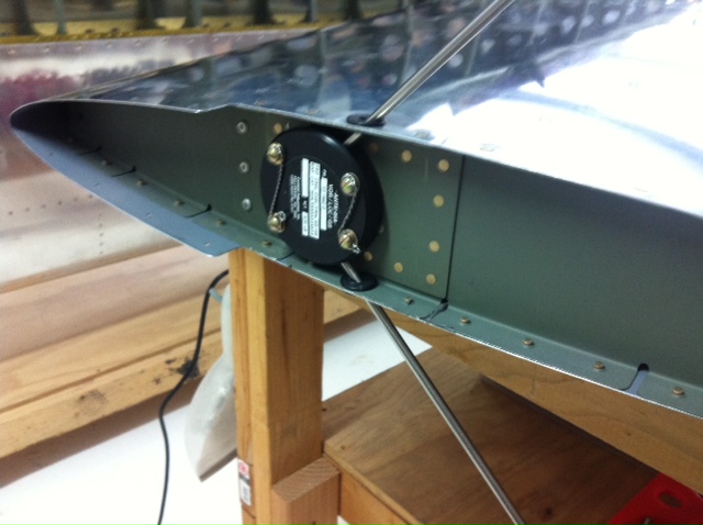

I hope this link to my KitLog Pro Log works; I'm not sure how their PHP is set up. If it doesn't, try going to kitlog on the web, search for Patrick Kelley and view the RV-10 project. You want the 9-21-20011 entry to start and the next one, 9-23-2011, to see how I fitted the antenna and conduit after I had already built the VS. I did have to drill out the top rib in order to put nutplates in for the puck.

I put a doubler with nut-plates under the top of the VS. I was concerned for possible stress on the structure of the VS and thought it better to over-design it now, rather than have a crack later. If someone can tell me how to attach pictures to this forum, I'll send those along, as well.

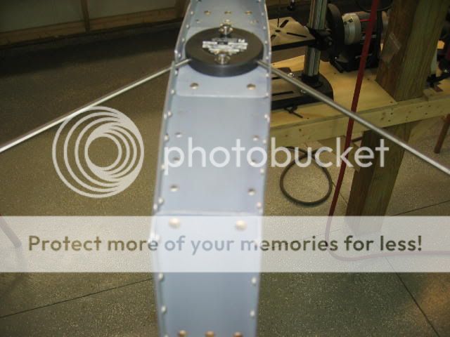

I mounted mine in top of the vertical. I wish I had some good pictures of it. I made a plate with nutplates on it and riveted it on the top rib. I had to make slots for on the vertical rib to accept the nutplates. I also have a hole in the middle for the coax. Riveting on the plate to the top vertical rib made up for the strength loss plus some. I carved out the two exits and screwed on the antenna. I also used some parker air hose, I believe 5/16 O.D. and ran that up the front of the vertical ribs. It works great and definitely better than my bob archer mounted in the wingtip. I recommend it. It is also out of the way so my dog won't poke his eyes out. He still might on the lower comm antennas;)
The rudder moves about a 1/2 inch above the whiskers and there is no way of interference.

Thanks for all of the great photos and information! The antenna I purchased was the RAMI version. I was so obsessed with the puck diameter, that I didn't worry about puck height. The RAMI puck is almost twice as thick as the Comant version. I never considered placing it under the forward portion of the rudder as mine sticks up above the skin and wouldn't allow clearance for the rudder. I was figuring it would have to go on forward part of VS inside the fiberglass tip.
I guess the RAMI is getting boxed up and heading back to Spruce.

Here is what I did.......
I returned the RAMI antenna that was not working and replaced it with a Comant CI-158-C2. I am very pleased with the outcome and think it turned out great.
I was looking at possible "failure" points by going with this install. The only real issue was having screws just underneath the moving rudder. I decided to go with AN500-A8-612 fillister screws and safety wire.
Here is a list of the basic parts needed:
Comant CI-158-C2 antenna
Vans black flex conduit
Misc AL sheet
2ea AN931-4-7 rubber grommets
4ea K-1000-8 Nut plates
4ea AN500-A8-612 fillister screws
Safety wire
Proseal
Thanks for all of the great input from everyone. I hope this helps anyone else going this direction in the future. I have some additional pictures at the link below.
