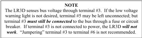

I'm installing my B&C L40 Alternator, and LR3D-14 Regulator in my RV8.
I've got a shunt right on the firewall between the alternator output and the buss. Rather than run the terminal #3 voltage sensor wire all the way to the buss, can't I just jump off the buss side of the shunt? It would be much easier than running another wire to the buss.
