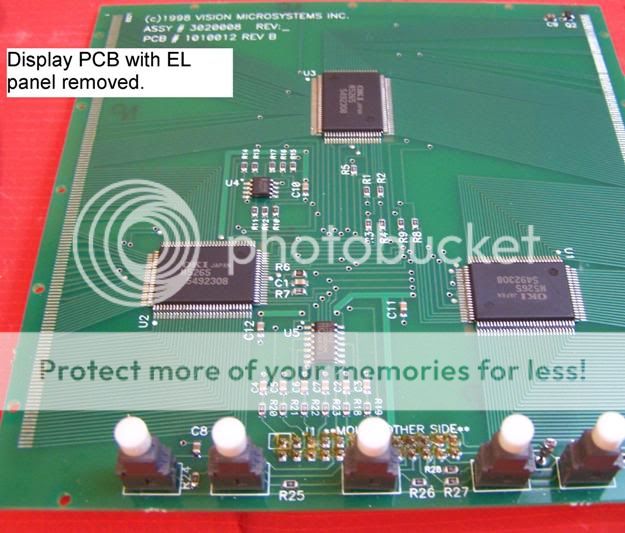

I've recently expanded my VMS repair services into the arena of VM1000 and EPI-800 display back lights. After completing a number of back light replacements on both systems, I want to pass along several observations to hopefully help your back lights to last a little longer, or at least provide some thoughts on how they fail and why.
I think one of the coolest features of the VMS systems is the back light system, little power usage and very readable even at quite low luminosity levels ... but it's very frustrating when you preflight for that beautiful clear night flight and find your display is black!
A little background first (for those who already know about the back lights and how they work, skip to the next paragraph). The VM1000 display and EPI-800 indicators use an electroluminescent panel (ELP) with a phosphorescent coating encased in a thin plastic laminate. The ELP receives an 80 volt AC excitation voltage at a frequency of ~400-800Hz from the small DC to AC inverter inside the VMS data processing unit (DPU). This AC voltage travels via the two outermost leads in the display ribbon cable to the VM1000 or EPI-800 units. In the presence of AC, the ELP glows with brightness modulated according to the level of the AC excitation which is in turn controlled by your aircraft dimmer input to the DPU.
An inop back light system is generally caused by either a failed DPU inverter or a failed ELP in the display unit. There are other possibilities such as chafing of the ribbon cable, incorrect or inop aircraft dimmer input, connector corrosion, etc. but I'm going to concentrate on the ELPs only in this post.

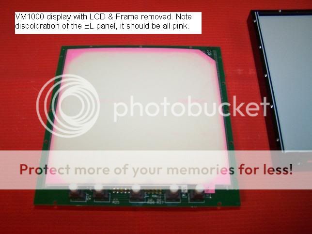

Because the ELP has a phosphor coating, it is suseptible to moisture damage from direct contact or high humidity. Hence, most ELPs today are hermetically sealed in plastic laminate. As I have found in repairing these units, this was not the case in the days when VMS manufactured their systems--almost 30 years ago (EPI-800s) or 20 years for VM1000s. Easily 80% of the ELP failures I've found appear to be due to humidity/moisture invasion of the phosphor coating via unsealed edges of the ELP, either not properly edge sealed or were cut and sealed with regular cellophane office tape which degraded over time. Once moisture contaminates the phosphor coating, it no longer glows. Based on the sample set I've seen, improperly sealed ELPs seem to last on average about 12 years. See picture 1 below.
ELPs also naturally degrade over time, this is usually characterized by the panel slowly getting dimmer with age at a given input level or perhaps developing "dark spots" at various points. In our aircraft usage profiles, ELPs seem to last about 15-20+ years if moisture has not been an issue before dying of old age.

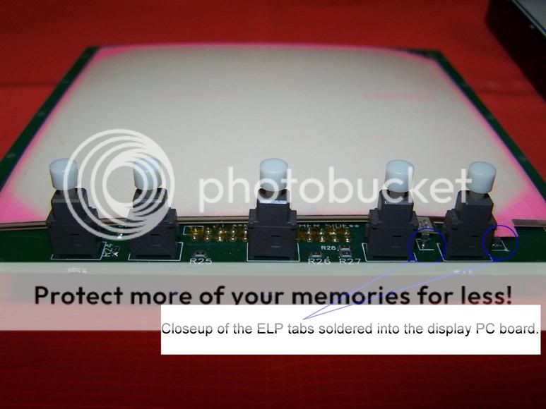

Finally, ELPs can fail due to excessive vibration or shock/blunt trauma (e.g. dropping the display). Now all aircraft vibrate, what I mean is really high frequency/high intensity vibration experienced at the display location. Such can be the case if the instrument panel is not adequately stiffened and/or not shock mounted and it resonates in flight at a particular engine RPM. The small PC board connecting tabs can fail in this mode (See picture 2 below). Similarly if there are longer/larger instruments tucked tightly against a display unit that amplify or transmit vibration to the display in a resonant mode. Thus far, I've only replaced one ELP that appeared to be damaged from vibration but there were telltale signs of fretting on the frame mount face and a large rub area on the side of the frame where another instrument was contacting it--worth doing a double check of your install to make sure you don't have these issues.
So the question becomes how to address these failure modes in a new ELP when it is time to fix the back light. First, the new panel must be air tight sealed with reinforced edges that will not readily degrade over time--cellophane tape does not cut it here! Next, the ELPs should be robust enough to handle normal aircraft vibration with good service life. Finally, they need some form of shock mounting inside the display to guard against the effects of resonation. See picture 3 below.
In my installations, each issue is addressed. First, by using a high quality edge sealing tape, double wrapped on all edges, moisture should be kept at bay. This is a super high quality poly tape, temp range of -100 to +120C, adheres well to plastic materials and has an adhesive that will not readily degrade, costs about $45 a roll; good news is a roll can cover a good number of panels. Second, a stiffer backing with larger edge electrodes as provided from my supplier, should translate to longer service life and reliability than the earlier generation ELPs. Lastly, I provide a barrier against vibration and resonation by using quality/non-abrasive foam mount pads between the ELP and PC board and strain relieve the PC board mount tabs; this should also translate to longer service life. Time will tell, but I'm very optimistic that these techniques and better quality ELPs mean no more back light headaches. So if I can help you out with a backlight repair/replacement, please feel free to email direct at [email protected]
