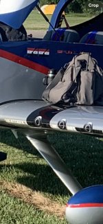

In 2017 I upgraded KELLI GIRL and me to IFR, and haven't been shy about flying through rain. However, the rain drops' impact on the vinyl's leading edge blasts away the outer pigmented layers, showing the inner cushion and lower adhesive layers. Case in point:
Look at the white invasion stripes on the wing's lower leading edge. You can see the ugly gray blotches. That's the damaged vinyl where the rain drops impact-blasted the white surface. That damage appeared on most of the forward-facing surfaces like the cowling, vertical stab, etc. After 8 years of continuing degradation, I was ready for something more durable...like paint.

Mark King at GLO Custom paint emphasized the need to get any residual vinyl sheet adhesive OFF of the aircraft. This need became apparent as I discovered just how well the original wrappers treated the surface edges and seams. Because I had placed such emphasis on zero water intrusion in 2015, the wrappers ran a strip of surface adhesive along the skin edges and skin seams:
![IMG_0171.jpg IMG_0171.jpg](https://vansairforce.net/data/attachments/31/31017-287e371f890c8d3c26278c7ab8148879.jpg)
Here you can see that "glue" strip along the wingtip edge.
