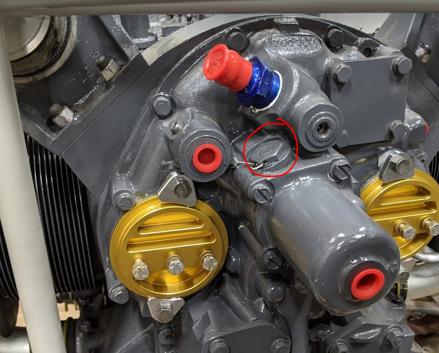

Thanks for the explanation, I think I see where the viscosity valve is (circled in the pic).
I'd like to avoid managing another control if I don't have to though.
Correct. Should be a spring and piston under that cap. Remove them if you install a vernatherm.
Interesting thanks for info. I don't know exactly how these work but looking at the adapter can the Vernatherm hole just be capped? Is there a way I can use the adapter and stick with viscosity valve?
Yes. The best way to cap the hole is to remove the guts from an old dead vernatherm and install just the machined aluminum tube portion.
Using the viscosity valve without a ball valve to throttle oil cooler flow may result in oil temperature too low, given low OAT.

I answered your PM. Basically, if I still have the vernatherm, it’s yours - just pay shipping. In looking at your picture above, I think the hex plug you have circled is where the oil temp probe goes, but not sure. Your accessory case looks different than mine. I don’t see where the viscosity valve would go. I have an overhaul manual and parts manual for an O-360 at the airport, and will try to figure it out when I get back to my hangar. Your oil filter adapter should have an opening for a vernatherm. It might even have an oil temp probe opening. I’ll send you an email later and let you know what I find out. Below is pic of the viscosity valve like I bought. Mine came with a spring. It looks like ACS sells it separately now.

I’m pretty slow on the draw here. That circled nut in your pic is about where my viscosity valve was, so I clearly don’t know what I’m talking about. But, I think I do have a vernatherm, and if I can find it, it’s yours.
