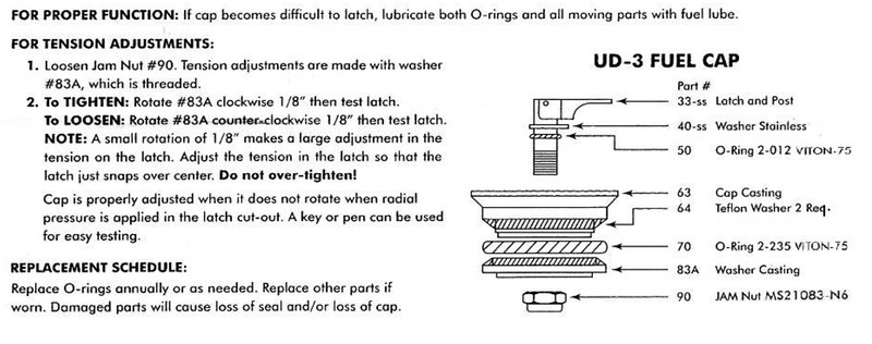

Proper adjustment makes the caps easier to open. Adjustment instructions and parts are shown below for Usher Fuel Caps. Instead of fuel lube/EZ Turn for lubrication many folks use Krytox GPL 205 grease with good results. Expensive, but the small 0.5 ounce tube will last a long time. Don't forget the small O-ring around the stem. Lubricate both O-rings and properly adjust the cap.
Parts are available from Van's:
Having said all that, I still have an RVPlasticParts fuel cap opener on my keyring! ;)

Great info. That little o-ring on the stem is indeed key, when it fails your cap turns into a funnel for rainwater to enter your gas tank. Ask me how I know. 🤣 When properly cleaned, adjusted, and lubricated the caps are quite easy to open — I was amazed.
