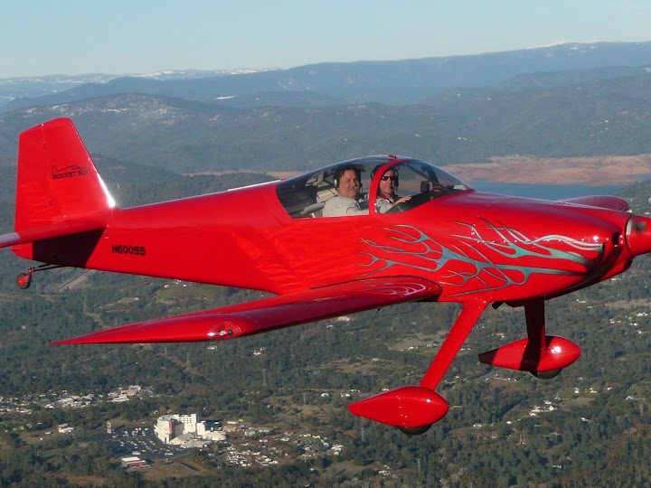

The Hallendorf Super Six (Rocket Six), built by Tom Hallendorf, now owned by me (4th owner), now home plated at Reno-Stead.

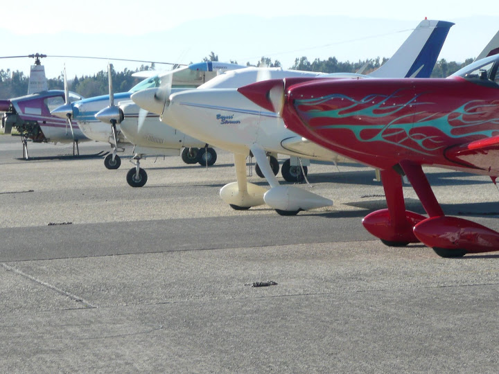

As for mods, the Barnes Stormer and Rocket Six have many similar mods, and some slight differences.
Steve's is a tip-up, and mine is a slider. Both have been lengthened in the baggage area...Steve's by 10", mine by 8". Steve added a baggage door in the side of the fuselage as well. Batteries are in the rear of the fuse, for W&B. The wings on both were clipped 3.5" on each side, much like the Rockets, which reduces the bending moment at the wing, and allows similar g-loading limits to other RV's at the higher GW, or so I have been briefed (my limits are 1900# max GW, 1550# aerobatic GW...it has a 1230# EW). The struts are HR titanium struts, which make them stand a little taller, providing clearance for the Hartzell 80" props. Thicker skin was used on the fuse, wing and ailerons (.032), and the second owner of my airplane re-skinned the tail at some point, also with .032, after seeing some cracks on the empennage. During my first condition inspection and during my panel upgrade (which had me upside down in almost every nook and cranny of the airplane), my A&P (who's helped build and re-build a couple RVs) noted some extra corner doublers on some of the underlying structure, and it appears that some beefed up members were also used (longerons and stringers, though I don't have good detail or confirmation on that). Vne discussions got my attention as I was buying the airplane, and the original steam airpeed installed in my airplane had a red-line of 260 mph. Of course, Vne is TAS, and the fastest I've seen level is 215 KIAS, 225ish KTAS at 8500 MSL (about 260 MPH). That was on the Dynon, but I was still calibrating it, so I'm a little suspiscious that it was reading fast back then). The day we flew with Pierre, we saw 209 KIAS/218KTAS at about 3500 MSL, which penciled out to 251 MPH TAS. The GPS showed 218 kts GS as well, with a direct X-wind, so it seemed like a pretty good airspeed. There were no "ill-effects" noted at all...smooth throughout. And that's plenty fast for me...no need to be a test pilot or push the flutter regime tests on my part! I normally fly at 55% (185 KTAS) to 65% (195 KTAS) power settings...sometimes just a bit higher to get 200 KTAS. Fuel flows at 9500 MSL are in the neighborhood of 10.5 gph at 55%, 12.5 gph at 65%, leaned 50 ROP at those lower power settings (I don't have GAMIs, so I've not gone to LOP ops on the ol' VM1000...want to baby the engine a bit!)
