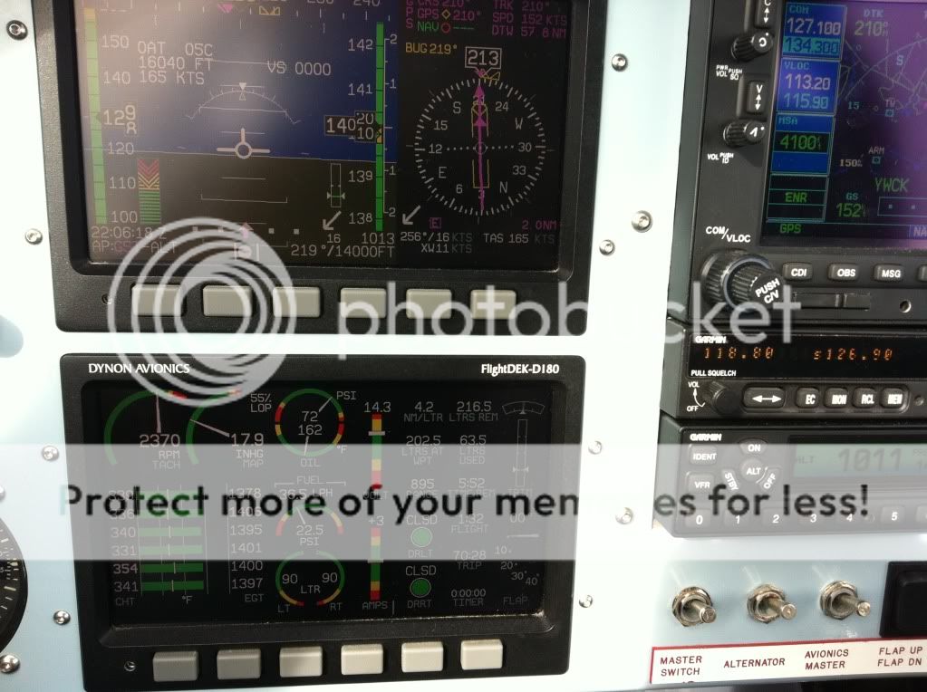

I have not used FL170 yet and I doubt I would but FL150-160 is not unheard of for us. We do get around 35LPH up there and a TAS around 160+ knots, depending on weight.
So if you keep your IAS under control, and hence TAS, it would be fine. The places where AVGAS is not easily found is growing, even here in Australia, however the problem we have is the distances you need to fly to find anything, could be a problem with Jet/Diesel as you will have less range so it remains to be seen.

RV10inOz thanks for the screen shot. I am always impressed with the RV10. For 2500 hours and 1/4 the cost, I can be up there with my rich neighbors in their Bonanzas. What a great machine. Can't wait to start a RV10 (maybe an RV12 first to get my feet wet :cool:
