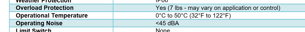

Most of the installation was straightforward, but adding the push-pull activation cable was going to require a new firewall penetration. This prompted me to look into electric operation. I selected an actuator made by Progressive Automations - their model PA-07. I wanted the entire cover, flap and mechanism to be a single unit with only electrical connections to the plane to facilitate removal, so I redesigned the activation to the aft end of the flap using a geometry similar to that used by AntiSplat's cowl flaps. It took some planning with cutouts, and a little bit of iteration to get the desired range of movement. I have a momentary 2-way rocker switch in the cockpit (similar to one used by many for electric trim). I opted not to have an indicator - up to down or reverse takes about 4 seconds and the actuator auto-stops at the limits.
