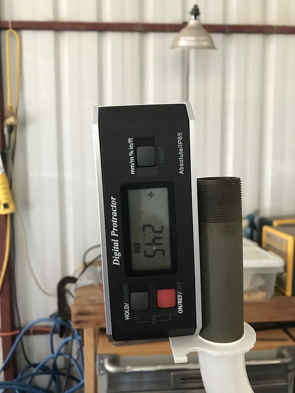

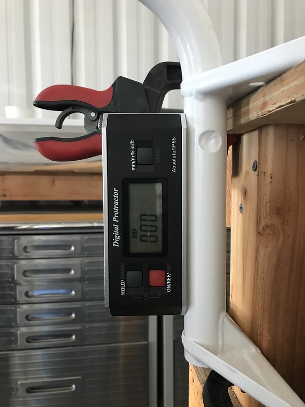

Probably with a level on the round bar stock, I would think.... place in a vice, so it doesn't move, and put one of those digital levels on both the fork section of tubing and the mount section of tubing, without moving. Take pictures of the relative same degrees, or how much it changes, top to bottom. Compare to what it is on your original front leg, in degrees. They should be close to identical, old and new. Maybe ask Van's what the specs were on the original front landing gear, they don't seem to have the wobble problem.
If the bottom of the landing gear is at an angle such that the bottom of the landing gear leg is IN FRONT of the top portion 3 inches above, with a forward rake, then when aligned perfectly straight, the fork and wheel is trying to LIFT the whole front of the airplane, and the fork will try to divert to the side and turn, due to gravity pushing the front end down. As soon as the wheel gets the least bit offset, it wanders even further away from rolling straight ahead. It's pretty imperative that that final section of tube that the fork pivots on is perfectly plumb, straight up and down, if you don't want the front end to wander.
Jig the leg in a vice or on a work bench to hold it steady. Zero a digital level on the firewall side tube then compare the lower tube. If you already have it on the plane you can zero the level on the canopy longeron then compare on the lower leg tube plus 90 degrees..

My replacement nose leg is bent one degree forward.

What is the acceptable tolerance between the top straight section and the bottom straight section?

Hey Brett, hopefully 1 degree won't be an issue. Please let us know what Van's says so the rest of us that are waiting for the part will know. Once the weight of the aircraft is sitting on the nose gear leg, maybe there will be a slight flex aft that might cancel out the 1 degree forward angle?? If not, maybe a hard landing or two will.. (JUST KIDDING) :)
