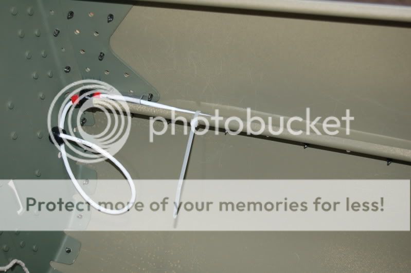

Sorry guys-- just now figured out how to post a photo. This is my fix to the potential stab trim servo wire chafing that was discussed a while back

Looks like a good solution BUT you may have to lengthen the trim cable at the instrument panel. I had to lengthen it at the panel end.
