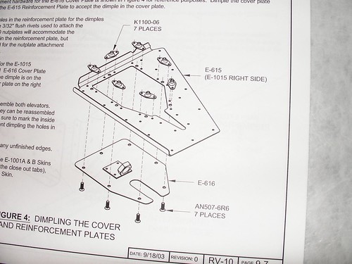

I am running into some confusion on the trim access cover for the Elevators on the RV-10.
I am not sure what size hole and dimple die to use for the #6 screws that are used to hold the cover plate on.
  1. What size drill should be used for the bolts?
  2. 2. Which dimple die?
    • I have a #6 dimple die, that seems to deep
    • Vans mentioned using a 1/8" die but that is too shallow
    • I have a 5/32" dimple die that seems about right.
  3. When I dimple the K1100-06 nut plate the dimple die contacts the dimple for the screw and slightly distorts the nut plate. Is that a problem?
Thanks for any advice

#28 drill bit is the proper size for a #6 screw. You're right that the plans don't call that out. It simply says to dimple the cover for the screw and leaves it at that.
The nut plate will sit off the skin when you dimple the skin for the rivets. You use a #3 die for the rivets and the #6 for the screw holes. I did not dimple the nutplate.
I'll have to disagree.
If you don't dimple the rivet lugs on the K1100 nutplate then the entire nutplate will sit 'proud' over the dimpled skin. I ALWAYS dimple the nutplate lugs, gives the nutplate a nice snug (flush) fit over the dimpled skin.
The nut plate will sit off the skin when you dimple the skin for the rivets. You use a #3 die for the rivets and the #6 for the screw holes. You do not dimple the nutplate.
Agree with Rick. I ground down the side of one of my #40 dies so it would clear the barrel of the nutplate and dimpled the lug without problem. My nutplates riveted on nice and flush. If you don't want to do that, I seem to recall that somewhere in Chapter 5 Van's says you can use a different rivet that has a smaller manufactured head requiring a minimal dimple. For me it was just easier to grind the die down.

Other than putting the dimple on the lug, it doesn't affect the shape of the nutplate. I must admit that before I dimpled the first one, I was concerned the the lug was going to bent or deformed due to the overall lack of material around the hole, but it turned out to be a non-issue.

I found that #27 was the correct size, but my #6 die does not fit in the hole?

I verified that #28 was the right size for a #6, but a #27 will work as it is slightly larger. If your #6 dimple die won't fit in your #27 hole then I question whether the die is actually a #6. I had ordered a #6 once upon a time but what I got was a 3/32 so mistakes happen. Sounds like what you might have is #8. Try drilling a #19 hole in some scrap and see if your die fits well in that. If it does, then you have a #8 die.

Just to close the loop on this.
When I bought my tools, I bought them off a forum user that posted them for sale. They were from planetools.com, and for the most part everything was unused.
The dimple dies came in the kit had labels for each position, and I pretty much took them at their word.
I was starting to go insane, thinking I didn't understand what was going on. The holes in the trim access cover are drilled to #27 (0.144"). I called and talked to Bob avery and he shared some of the dimensions on his dies. He shared with me that the pilot on the #6 die should me .135" flaring out to .285"
Armed with this information, I set about measuring my dies to see which one would match, or come close to matching, these dimensions. Not one of them was anywhere close. In fact, only 2 would even fit inside the #27 whole. The 3/32", and 1/8" dies.
So, good news.... I am not insane. Bad news... I don't have the correct dies for a #6 screw. I had already placed an order with Avery for a couple other items, so I went ahead and purchased a set of the springback dies from Avery.
I really like the plane tools set, which I liked mainly for the DRDT2, but most of my tool purchases since have been with Avery. They do a great job, and are incredibly friendly.
Now, I need to get some specs from Planetools.com and see if I can understand what I actually have.
